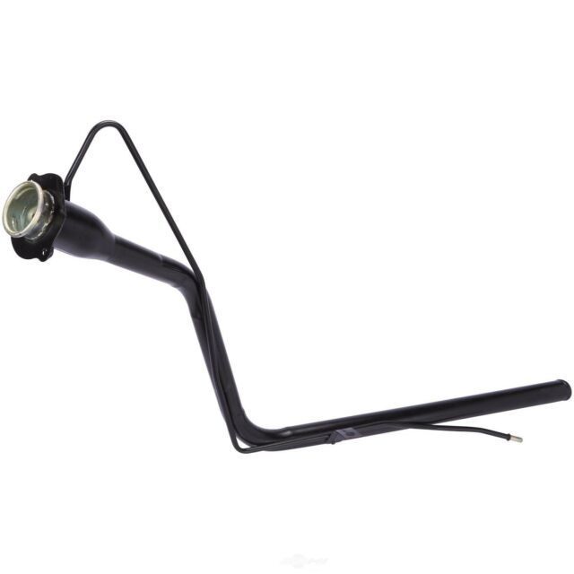

The cap doesn't stay on. It doesn't close fully. The problem is definitely here at the gas cap. When I buy an oem cap it will make the engine light go out for about 2 weeks and then we start the cycle again. I thought maybe if anyone has had the same issue that there might be a brand that works. Oem doesn't seem to do it.

You have managed to distort the tube if the cap won't stay on. Might have been nice to lead with YOUR problem, totally unrelated to the thread you are trying to hijack. Moving relevant bits to a new thread.
Did everybody miss this bit?

Then it’s the fuel neck that requires replacement
