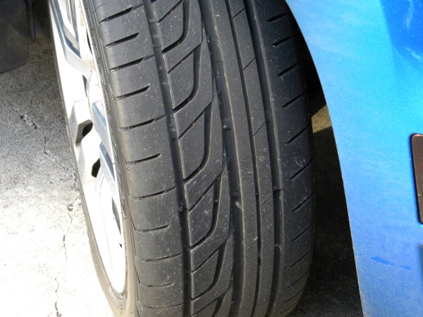

I think you mentioned that you had to purchase a tire and three were replaced was the odd tire on the left front?
Just watch the tire wear as you drive it.

I had some pulling issues, turned out to be separated belts in the Goodyear F1as. New tires no pull, funny I switched to the same tire you have now.
Love the looks and performance of the potenzas can't believe how many different model potenzas they make
