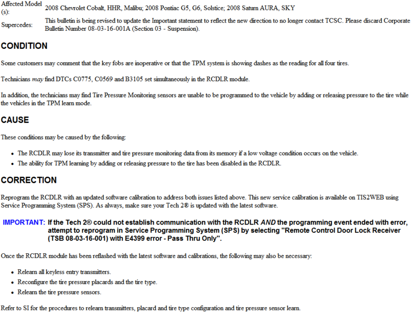

....after having the repairs done at the dealership the key fobs for my 2008 Panel don't work. They don't lock or unlock the driver or passenger doors. Side cargo doors don't pop open and the remote start doesn't work. Body Shop guy was quick to blame the battery in the Fob which was changed 3 months ago and the spare fob doesn't work either. What could they have screwed up during the repair? Fobs worked fine the day I drove the car in to be repaired.

Try a car battery lobotomy, check grounds and fuse box under the hood, look for #23 fuse per

This has been coming up a lot lately. TSB # 08-03-16-001B.
I think there is an additional step for panels, so find a tech that knows about panels..
