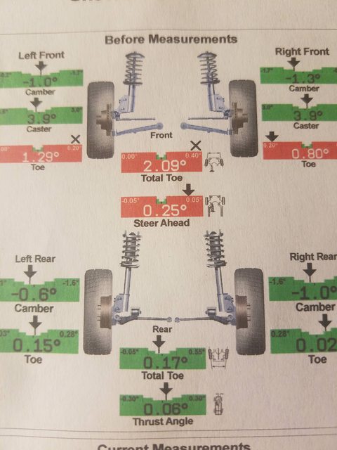

UPDATE: went to new mechanic to have them check the alignment and look at the wheel bearings. Apparently the toe was out 1.29 and 0.80 respectively and as for the noise? There was a small piece of metal embedded in the right inner brake pad, it was a piece of springy metal which is why the noise did not change when I hit the brakes. The first mechanic missed it and apparantly didnt tighten down everything correctly after the alignment

The "piece of springy metal" is the wear indicator that was not installed correctly. So all around technician error.
