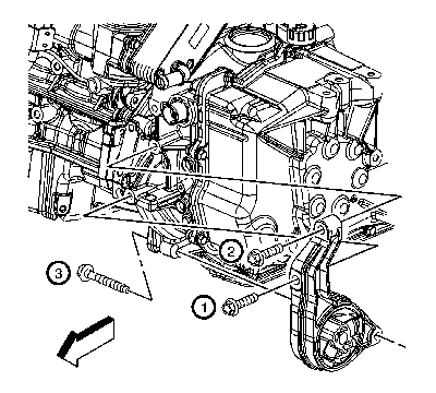

So tomorrow I am planning on tackling replacing my stock front tranny mount as it is pretty soft and cracked. I am just dropping in a OEM plain' ole rubber mount. Eventually I'll go poly. I was just wondering the best way to go about this, and If anyone can chime in that has already replaced it. So far I purchased 16,000 pound Rhino Ramps to raise the front of the vehicle up. Do I just jack the tranny up, and unbolt, or....? Thanks!

Should only have to support it,,then after the main bolt removed you can jack if necessary...

Transmission Front Mount Replacement
Removal Procedure
1. Raise and support the vehicle.
2. Support the transaxle with an appropriate jack.
3. Remove the front transaxle mount thru bolt.
1. Remove the front transaxle mount to transaxle bolts.
2. Remove the front transaxle mount from the vehicle.
