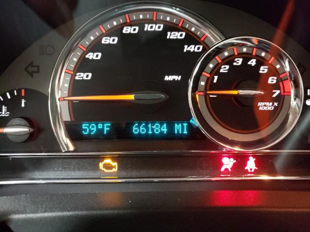

Looking at a 2010 HHR SS Victory Red Auto with 66,xxx miles on it. It has a MN Cert of Title-Salvage, and looks to be in ship shape, other than the inside roof airbag has blown.
My question after the background here, is, Does the Airbag Light, cause a CEL to also be illuminated on the dash? (Picture Attached)
Now, I know buying from a Salvage Auction, even with it saying normal wear and tear, it could have more wrong.
Old May 15, 2021 | 12:16 PM
Posts: 26,541
No, but it should be easy to get a reading. Does it light when the engine is running?
Problem is you can't just replace the bag, there are other one time parts. SDM (+programming), rollover sensor, yaw sensor etc. You can save $1000 doing it yourself, except for the programming.
You know DonBrew, I am not sure. I am here in MI, and the SS is in MN. This image was taken from the Salvage Auction page for the vehicle. The current price on the pure sale is $250. That's the only reason I am even looking at it. Replacement bags are $225 for the pair.
The pictures on the Auction page don't really reveal a whole lot about possible cause for the roof airbag being blown.

Posts: 26,541
That price for airbags is a lot less than the ones I got at a good price 8 years ago. Should not get used bags.
Like I said you HAVE to replace other parts and program them. Been there, done it. The total price might be the cause of the salvage.
