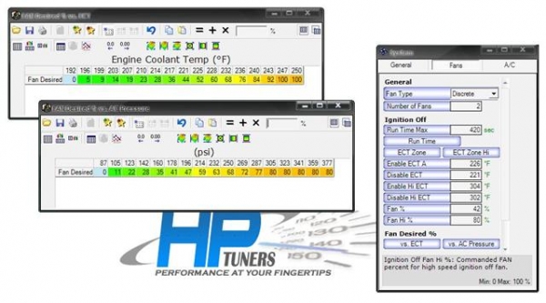

BTW, the fan speed is variable and controlled by the ECM. It kicks in at 5% at 196*F and varies via a set table, hitting 100% at 247*F.

The OP didn't say which engine he had, but attached is the actual fan settings from the '06 2.4 E67 ECM. They are the same for auto and manual.
GuitHHR, where did you get that data? Little corresponds to the HHR settings.
That info is right from the GM online service manual. It makes perfect sense you you look way back to when front wheel drive cars with fuel injection and electric cooling fans started coming out the fans were set to turn on at about 220 degrees. Also as far as gauge readings many cars have a seperate sensor for the IPC gauge and one for the ECM. and the temps between the two can vary sometimes. I'm not saying cmelvin doesn't have a problem. I mean I havn't seen the temp read out on my HHR get above 210 myself and is been 105 degrees here on some days. All I'm saying is that his service manager wasn't lying when he said the fans should kick on at 223 degrees. I think that if his temp read out is reading that high something probably isn't right based on comparisons from other members.
