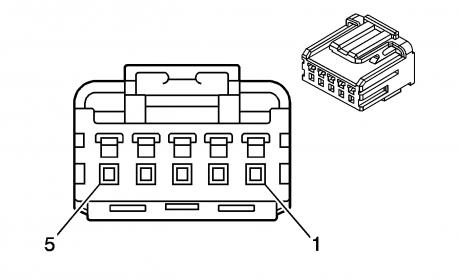

Inflatable Restraint PASSENGER AIR BAG ON/OFF Indicator Pin
Wire- Circuit- Function
1- 0.35 TN/BK- 723- Passenger Air Bag On Indicator Control
2- 0.35 BK/WH- 651- Ground
3- 0.35 PK- 353- Passenger Air Bag Off Indicator Control
4- 0.35 PK- 339- Ignition 1 Voltage
5- 0.35 PU- 5234- Passenger Seat Belt Indicator
Have you tried plugging each item in one at a time to see where the problem lies?
