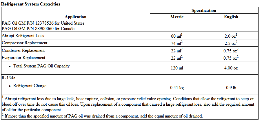

First the torque for the plug is 16 N.m. 12 lb. ft.
Attached Thumbnails How to repair - Accidentally removed the drain plug on the a/c compressor-refri.png

If he takes it to a shop, they're going to guesstimate the amount of oil too. There's no way to measure how much oil is left in the system. If they did a complete flush, vacuum and refill then you could refill with the total oil capacity.
Looks like 4 ounces according to donbrews chart. But doing a flush would cost a whole lot more.
A professional recharge for $40 may be right but we're not talking about just a freon recharge in this case.
