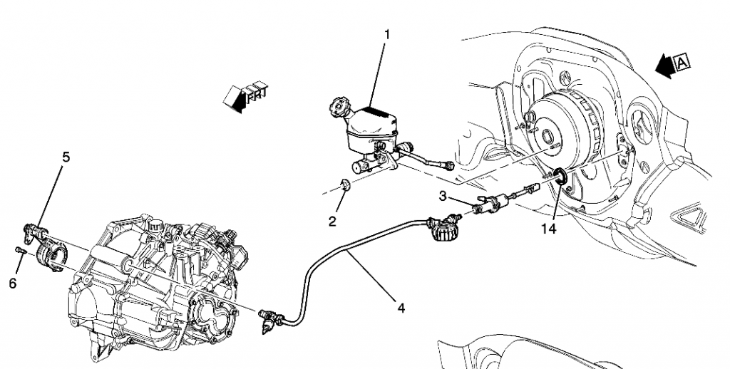

A few days ago the clutch pedal went to the floor. Upon inspection is looks like the fluid line is leaking. Right where it turns toward the engine/trans.
So far his line is real hard to find!

Do you mean you are having trouble finding an exact fit part to replace the line to the clutch?
Most times they come as bare lines, you have to bend and sometimes flare yourself. Should be standard brake line.

I am guessing that you are wanting part number 4 in this diagram. That is the preformed hydraulic line for our cars. The diagram is from a local Chevy dealerships online site and shows a price of $56.90 list. You should be able to get this line from your local dealership as well.
