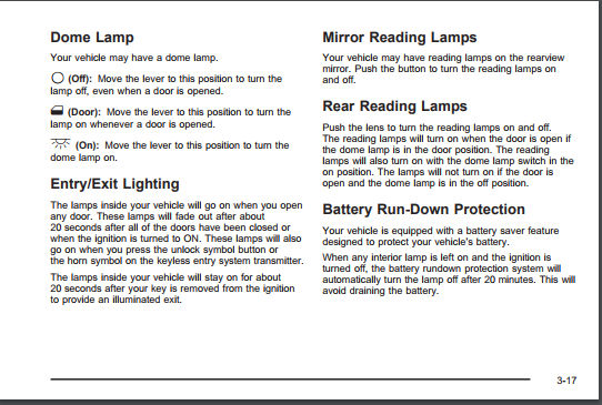

What issue do you mean? The melting, the auto off/dim, they stay on all the time?
You may have had the wrong bulbs in the fixtures. That is a common reason for the DRL melting on 2006 models; the parts books erroneously cross ref a similar bulb; sure it "works" but it is hotter than spec.
There is a switch on the dome light to choose "on", "door" and "off". Sometimes the switch gets melted so that it doesn't work properly. Usually from people playing with it and forgetting what position they left it.

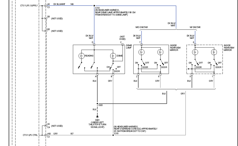

Posts: 26,533
The wiring diagram shows 3 different selector switches two on the mirror and one on the dome.

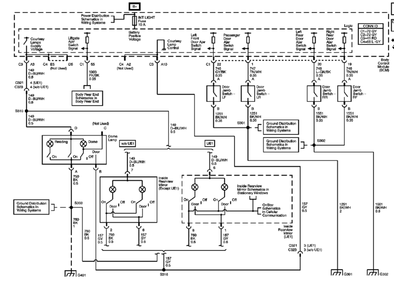

Here is the schematic.
