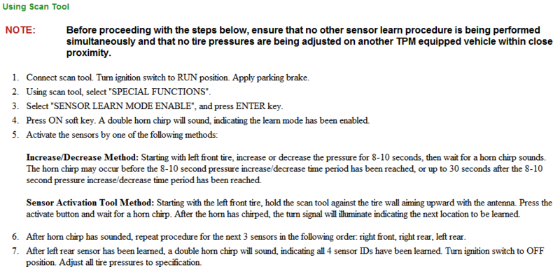

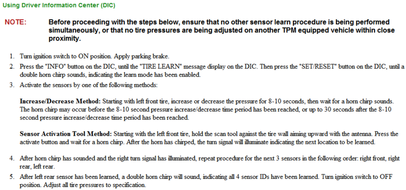

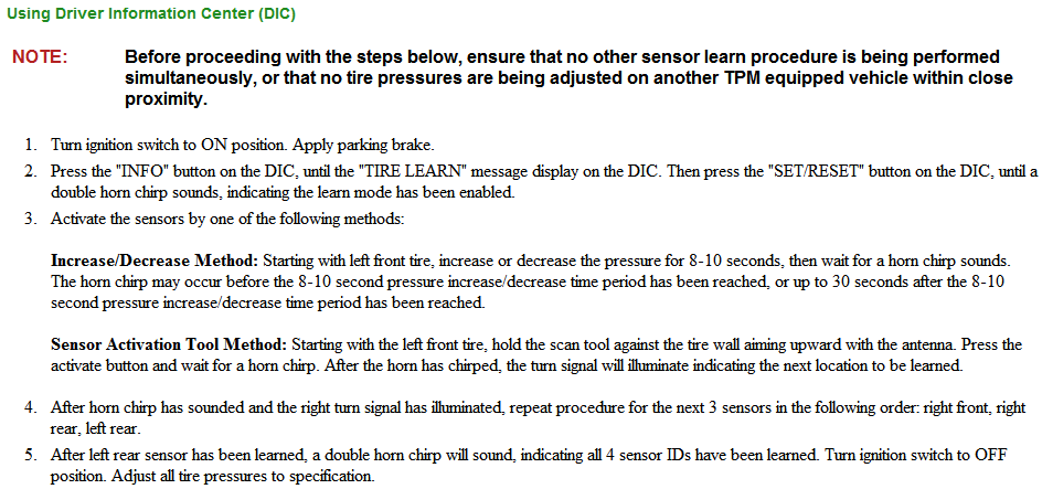

This procedure should work, 2010 is different, I have never had one.

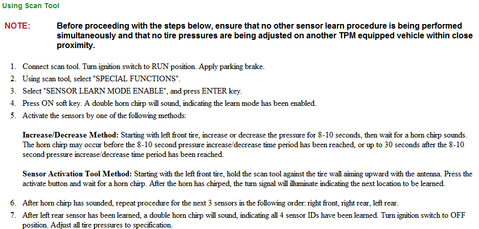

Or this with a Tech2 or equivalent.

Thank you very much for this info. I dont think "tire learn" comes up on the dic. I saw in manual to do it with the fob, but mine dont work. Got some things to check & look into. There is " discount tire" stores here also so I can check out what that other reply said. THANKS AGAIN!!!

Your guys SnapOn may be able to do those Tech2 procedures, depends on the computer he has.
Open your hood and look at the hood latch; if there are wires attached to it then you do have remote start. 2010 was an odd year, and my shop manual gives some odd information.
GoOgle tells me that UJM means you need a Tech2 or equivalent to relearn.
