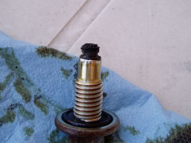

Last October when I changed the oil I installed a magnetic oil plug.
Look what it collected over the last 10,959 kms (6,809 mi):
Is that normal?

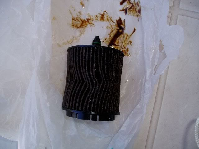

Here's the twisted filter:

Yes. For that many miles between changes.

My mistake, I misread your post. But the shavings/debris are pretty normal looking.

Sometimes its funny....I'll have twisted oil filters and other times not...I've used Fram, Supertech, Purolater and OEM. The Purolater looked like and accordion when I took it out and a couple of the OEM's have have the twist also...
My last change with PP I discovered metal shavings in it as well...never noticed shavings with the other changes but maybe because the filter was not so twisted that I didn't look as hard
Are you going to send it off to Blackstone for a UOA? I recently posted one over on BITOG and the results were really good for about 7300 miles...I think I had that in since January...OLM was at 41% I think...iron was a bit high but rest of wear metals were low and TBN read at 3.5 so I probably could have gone a bit farther with that oil than I did.

Yes, I took a sample to send off to Blackstone. Will be sending it out next week.
The one I sent in last fall was for just over 8000 miles on Castrol Syntec and it came out great.
No idea about shavings in past oil changes, as this is the first one with a magnetic oil plug and the first 3 oil changes were done at the dealership and the one I did in the fall was with the stock oil plug.
This was my first run on PP. PP is in again, since I still have enough oil for four more changes.

UOA back from Blackstone
Got the results back from Blackstone, no problems reported.

If the cap and filter are not alined when screwing down the oil filter cover it will give the filter a little twist.
