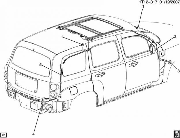

Wow....didn't know that Chevy had changed the routing of the drain tube. I think we the members, have erroneously mentioned down the A pillar to the front underside....if I'm not mistaking. Do you still have exit points in the front as well?
Unless additional drain lines have not be mentioned.
Old Feb 9, 2015 | 07:58 PM
Posts: 11,721
The 2 front drains go to the A pillars.
The 2 back drains go to that spot at the rear of the car.
At least, that's what I recall from a diagram that someone posted a while back

I've always checked the fronts never knew/realized there are drains in the rear. Now I need to go look for them..........
Maybe tomorrow!!
Old Feb 9, 2015 | 09:46 PM
Posts: 11,721
Here it is Snoopy. Shows the drains on the right side. Just have to visualize the left side ones.

Thanks fireman.......
You know, I had the headliner out when I did the windscreen repair (performed several years ago according to the TSB that was provided by ChevyMgr) and I do not even recall those rear drains. Good thing I don't turn wrenches for a living.
