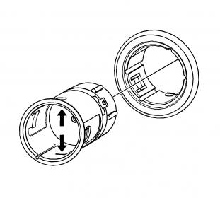

How do you replace the back socket in the console. I know you have to remove waterfall to replace the front one.
Chevymgr told me that but he didnt say how to remove the back one in the console.\
This is the tool we use:
1. Remove the auxiliary power outlet fuse from the fuse block.
2. Remove the receptacle:
2.1 Look into the receptacle. There are two 3 mm (0.11 in) tab windows 12 mm (0.47 in) from the front of the receptacle. The J 42059 Cigar Lighter Socket Remover pushes the plastic latches from these tab windows and the receptacle can be pulled straight out.
2.2 Place one side of the “T” portion of the J 42059 Cigar Lighter Socket Remover into the tab window. The J 42059 Cigar Lighter Socket Remover will not fit straight into the receptacle. Angle the J 42059 Cigar Lighter Socket Remover slightly for insertion into the receptacle.
2.3 Insert the other side of the “T” into the opposite tab window.
You must move the J 42059 Cigar Lighter Socket Remover handle toward horizontal to engage the other tab window.
2.4 Use the J 42059 Cigar Lighter Socket Remover to pull the receptacle straight out.
Attachment 13474

Attachment 13475

Attachment 13475
So the front and the back sockets come out differently.
