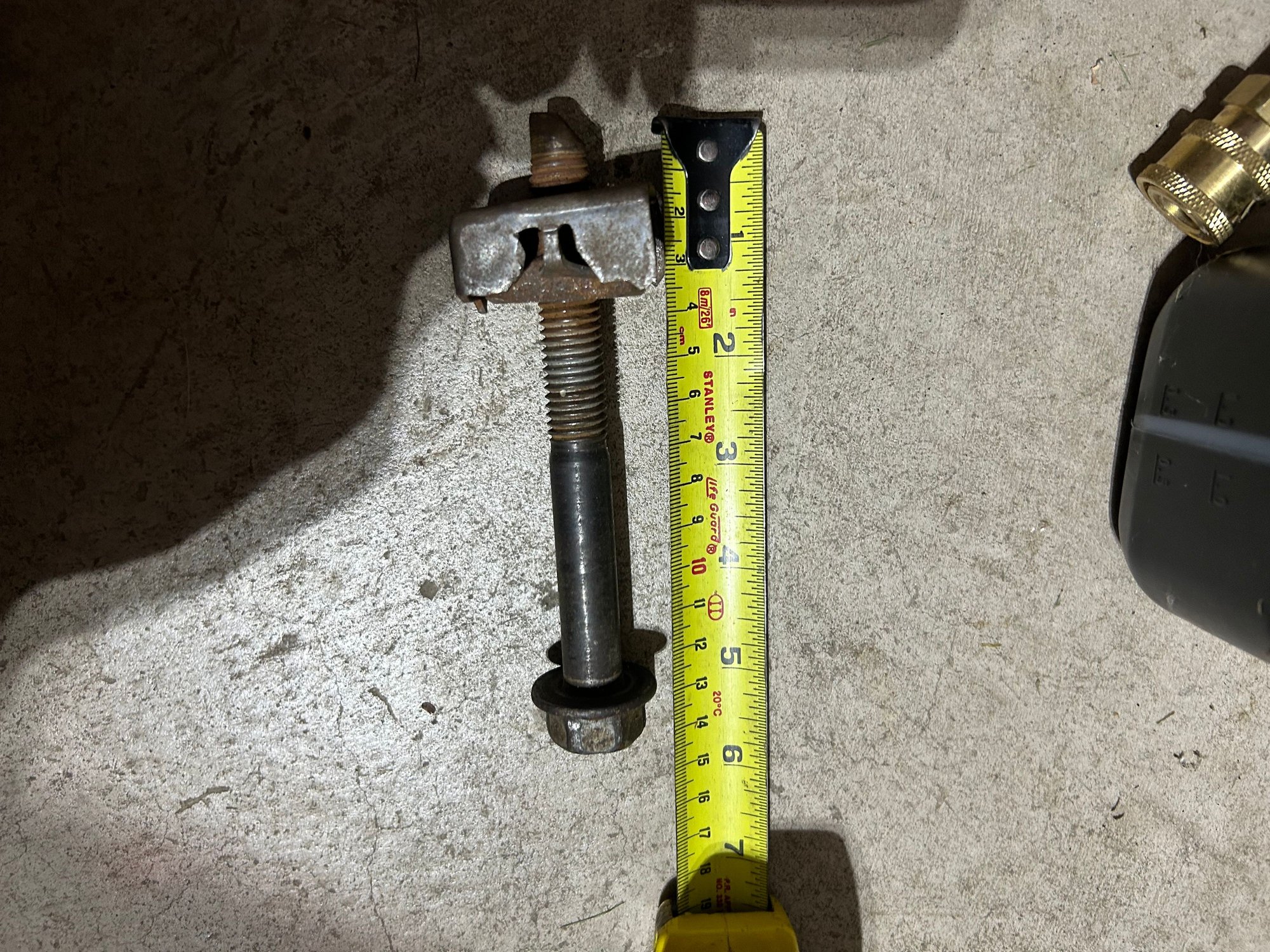

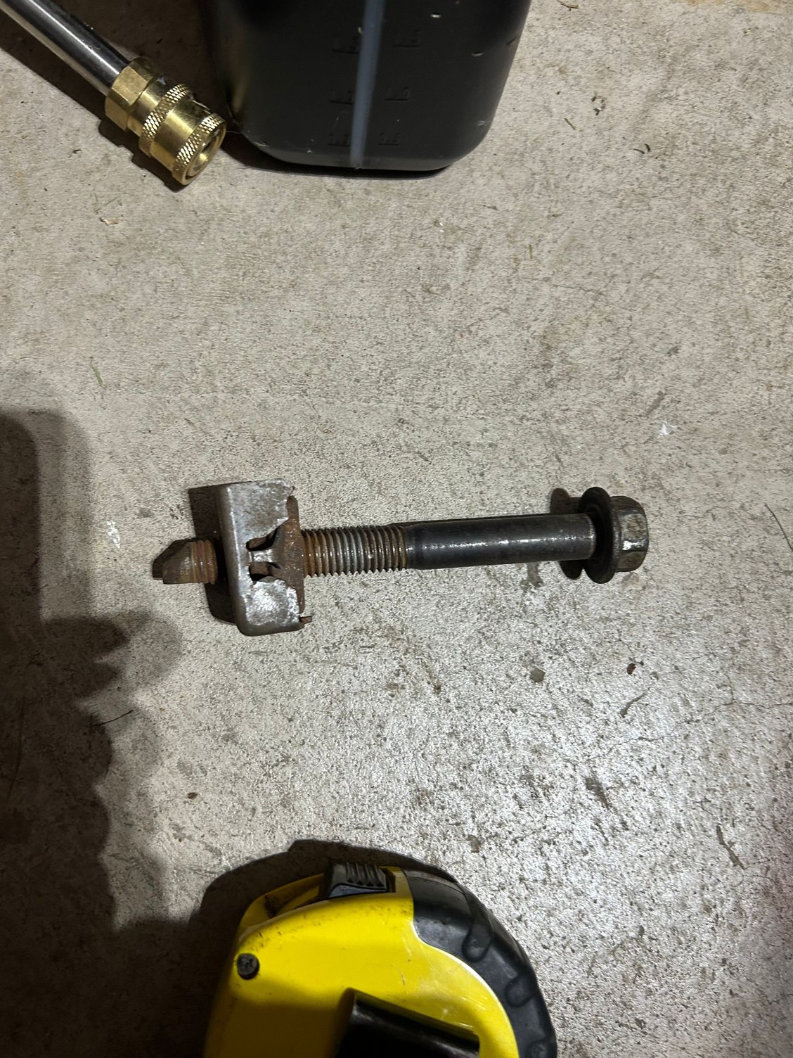

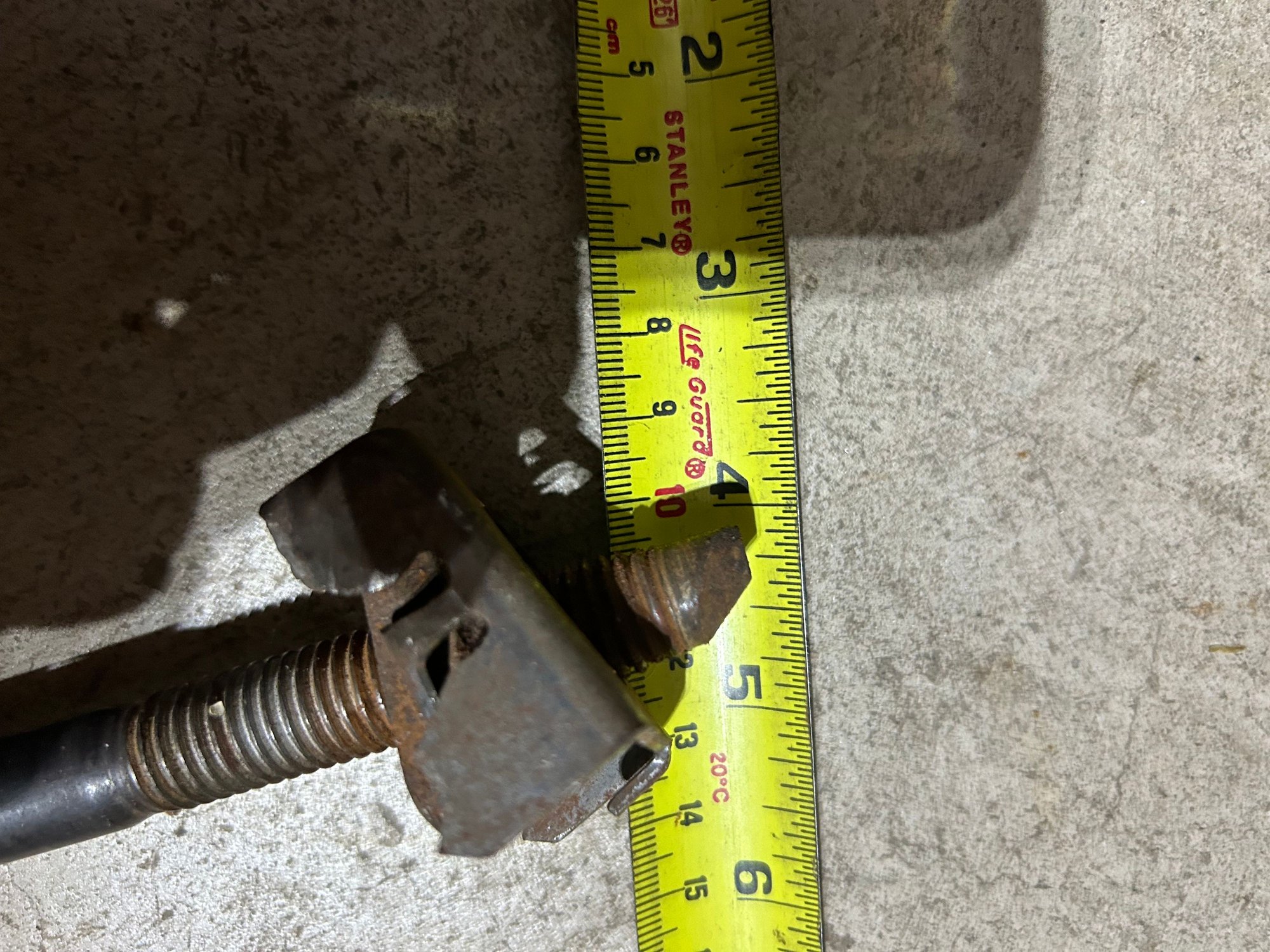

Coffee was awesome, morning chores are done, so I dug out an original OEM bolt
OEM bolt with cage and cage nut
The bolt is 5 “ or 13 CM long
You can see here the bolt has a self cleaning tip to ease installation. I use anti seize in the shank and the threads
