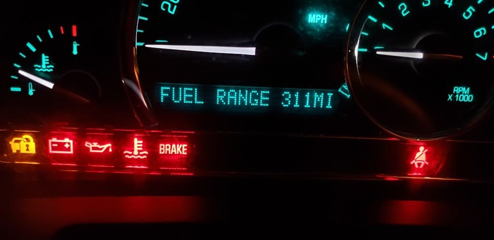

At this point I'm wondering why the check engine light *wouldn't* be on. I turn the key on and I can't see the check engine light illuminated on the dash. I'm not real familiar with HHR dashes so I'm attaching a pic.
I'm wondering if there is serious wiring issues in this car and someone just disabled the check engine light? Am I dealing with a lemon? What is her possible recourse if something serious is wrong with this car?

Possibly then CEL fuse is burnt out or removed, the wire is just visible here to the lower right of the air filter box

Yay, thank you! Ok I found the MAF wire and plugged it back in. Will clear codes and see where that leaves me.
I didn't see any fuse which was the CEL fuse. Online they were talking about #29 but in that instance the diagnostic port wasn't working either. My #29 is fine.

The diagnostic port is powered by the cigarette/power port fuse.

If it is still under the "certain national used car chain" warranty take it back. If not address it anyway. A non functioning CEL is a safety issue, most states it is a reason to flunk inspection.

Is it possible that you are seeing pending or historic codes? They would not light the CEL.
