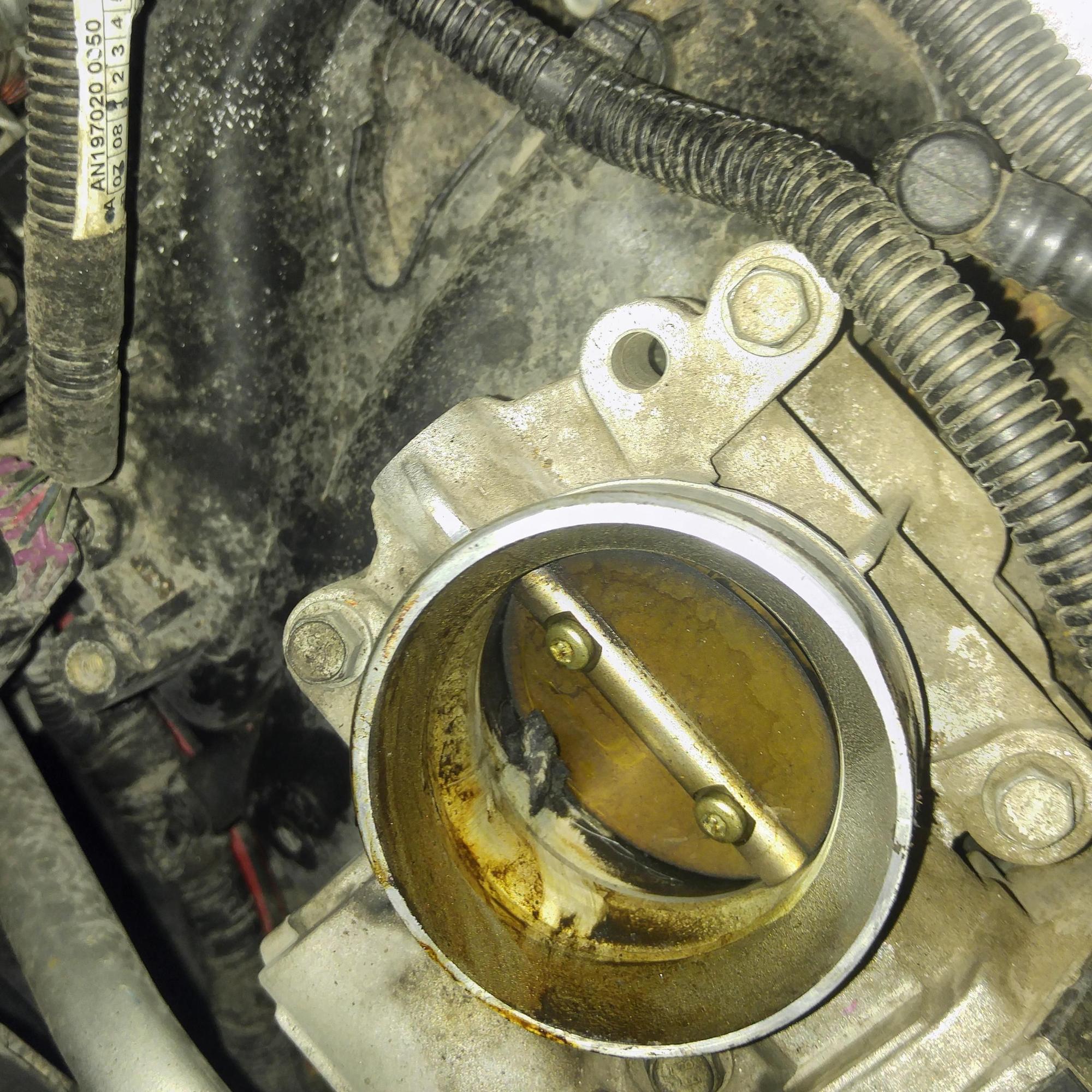

So..car starts running poor.. I bought good air filter and cabin filter..I have a cheapie code reader..P1516 and 2176..googled the codes.
Air filter seems it was "checked" the screws all loose..the cover flopping around and cold air hose ripped and shoved behind cover. the grommet mount bracket broken on passenger side.
. NEVER..never go there again.. No reason to complain..they will deny everything. I managed a 11 dealer chain..Saturn my last stop in car biz..
Wife loves her HHR..we find it excellent around town or Tucson to Breckenridge Co..
Well..it kept me from fixing the blown U Joint on my resto mod..53 Stude 383SBC etc). Lit up the tires one to many times..buying filters for HHR. so..didn't get to work on it..but her Red HHR is excellent..159,000 miles..
If any one here works at a Midas..maybe your's is different. I had bad experience years ago. NEVER AGAIN..
Could this be why it's missing..with decreased engine power..? Felt from inlet hose..mixed with gummed gas..and filt dust.. She drove maybe 150 miles in town,,Tucson dust..
Filter looks like a moron forced it back on UPSIDE down.. Cleaned MAP..obviously cleaned the TB and runs perfect..

Yes, that is an extremely filthy TB! The ultimate cause of the codes, it may have broken something else in the TB.
Midas is pretty famous for that kind of experience, along with fake repairs; ATF flushes that never get done etc. AND unplugging MAF sensors on purpose.
