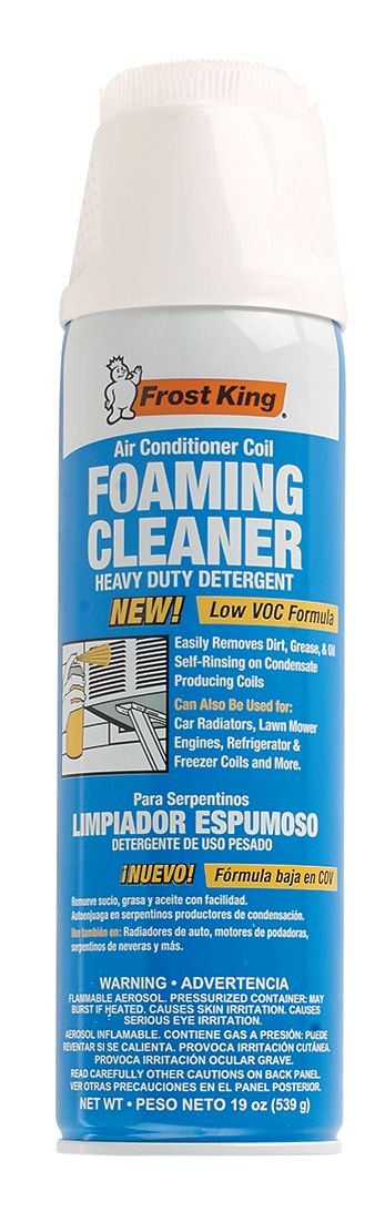

Why not follow up on the rumors and go to an auto parts store, look in the AC section an pick up a can of aerosol AC evaporator cleaner? Many brands available. I would look for the foaming anti-bacterial type.

If your NAPA store has a floor display of freon that is where it would be. The counter guys don't have a clue what is on the floor.
