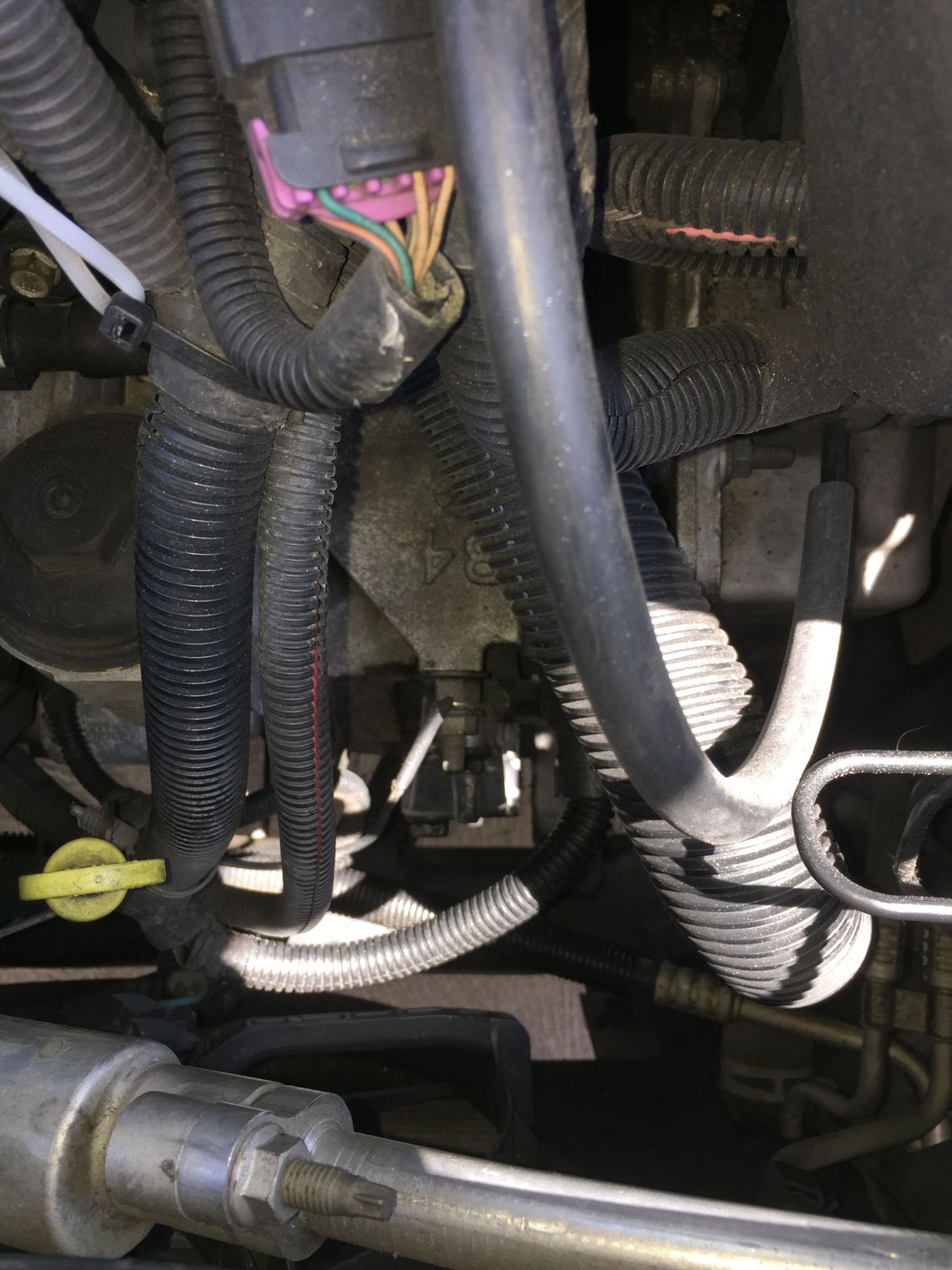

https://cimg0.ibsrv.net/gimg/www.che...54e20f1ff.jpeg
Top two bolts for the front mount

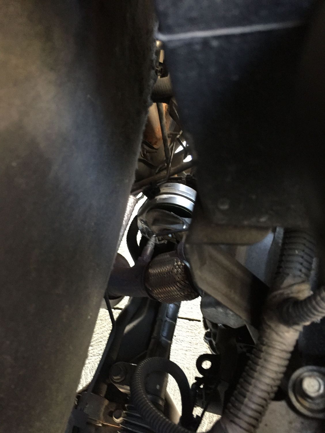

The rear mount hides down there!

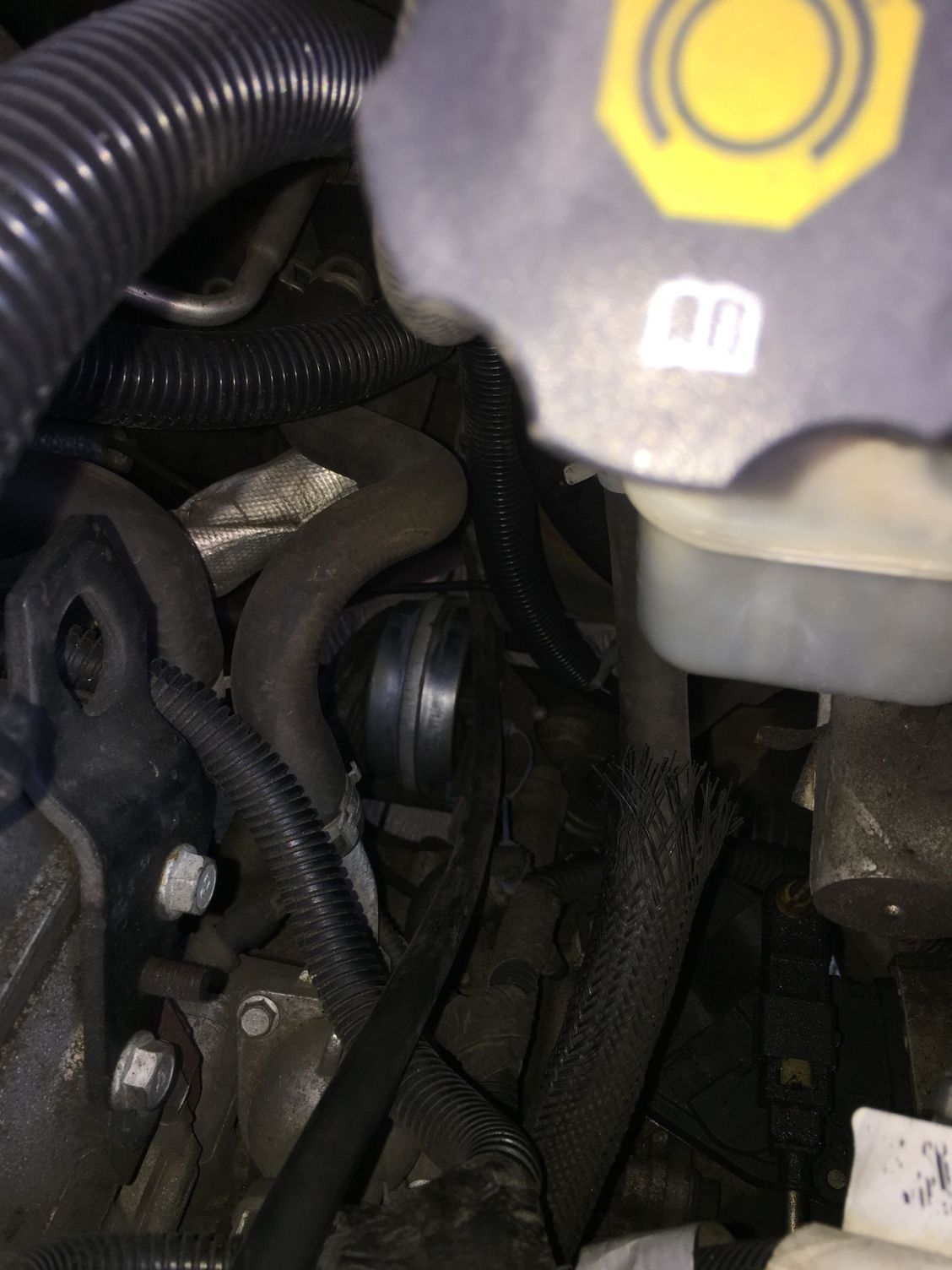

The two top bolts flash on!

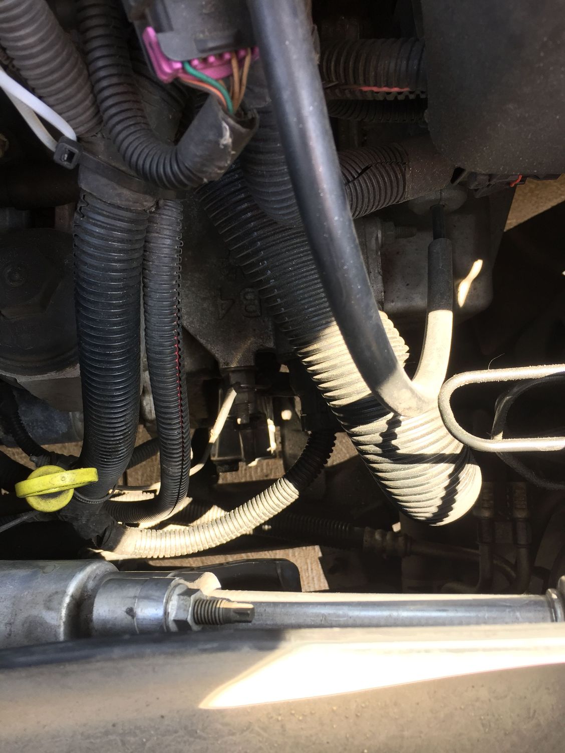

https://cimg4.ibsrv.net/gimg/www.che...fce92d7a8.jpeg
These two bolts at the bottom of the front mount, easy access

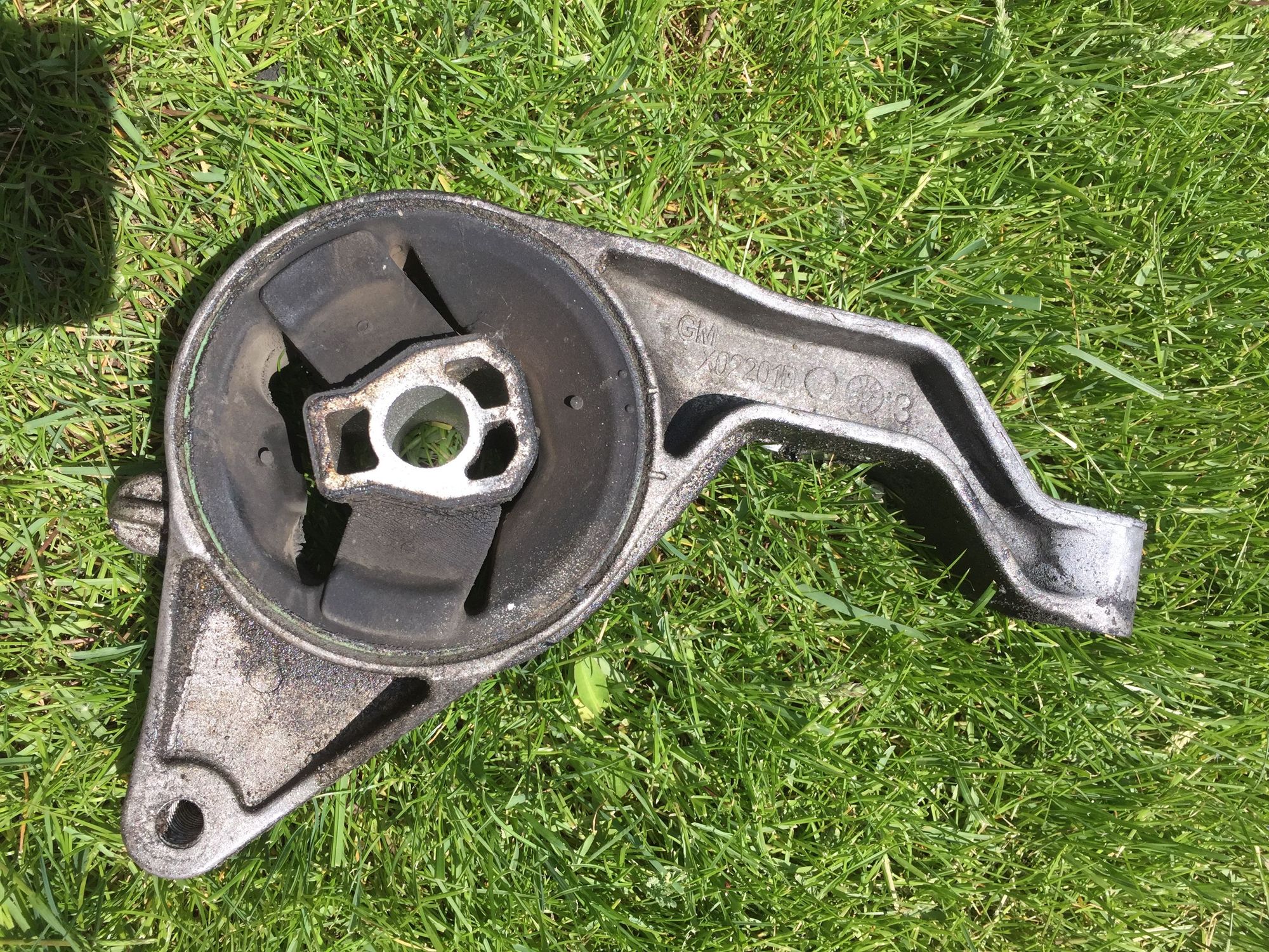

https://cimg7.ibsrv.net/gimg/www.che...444e5544b.jpeg
Rear mount , in the sun first time in eleven years, note the cracking of the rubber to the left of the centre bolt hole at the edge of the rubber biscuit.

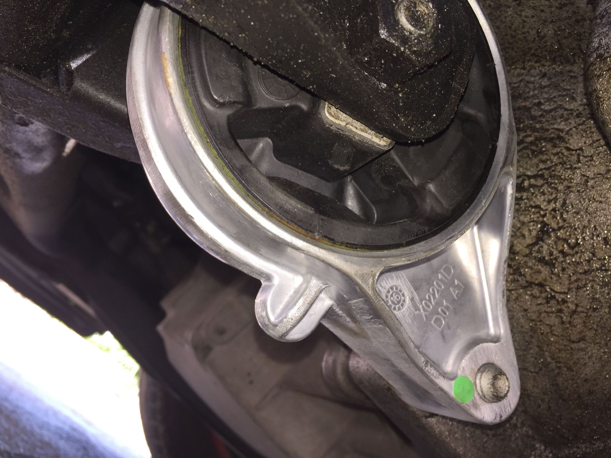

https://cimg9.ibsrv.net/gimg/www.che...10a84bd2a.jpeg
Old front mount, the bottom is to the left note the wear marks from the centre bolt pin to the rubber.
