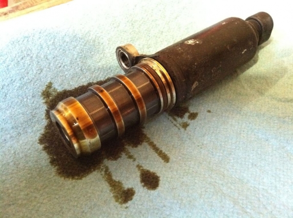

Checked the cam actuator solenoids and they had 13.1 ohms of resistance. I also used jumper wires to activate the solenoid. I could hear and see both of them working.

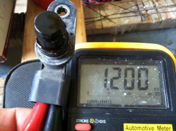

Removed both cam position sensors and they had 1200 ohms of resistance. I cold also get the sensors to create up to .25 Volts AC by waving a metal object past the sensor.

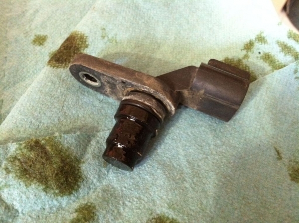

The camshaft position sensors were covered in an dark brown oily sludge but I don't think that would affect their accuracy.
I went ahead an ordered a couple new camshaft position sensors anyway.

Also what about this sludge you speak of?

As to the sludge, it is brown and is not truly sludge but really dark and thick oil. I've used synthetic oil since 15,000 miles and the car does 90% highway travel. MPG hasn't changed much and is around 28.
