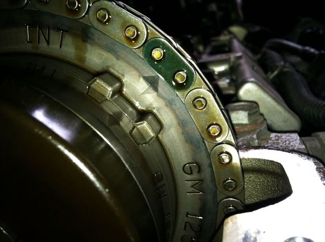

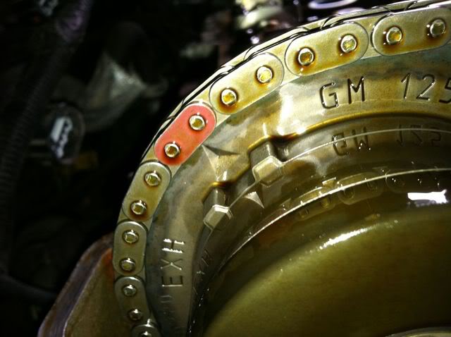

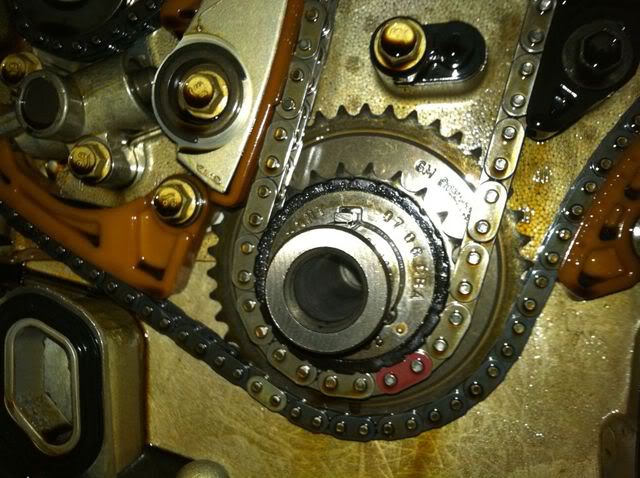

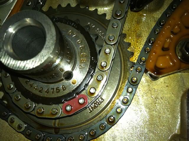

Base Timing
Pulled the timing cover and turned the engine over 6 or 8 times until the three marked links lined up. It looks like the chain skipped 1 tooth on the crankshaft sprocket. I think I will have to replace the chain, crank gear, tensioner, guides, and both actuator gears to be safe. Not sure if I can get a kit with all parts that I need. Can I replace the chain when the cams are at overlap and not on the compression stroke?

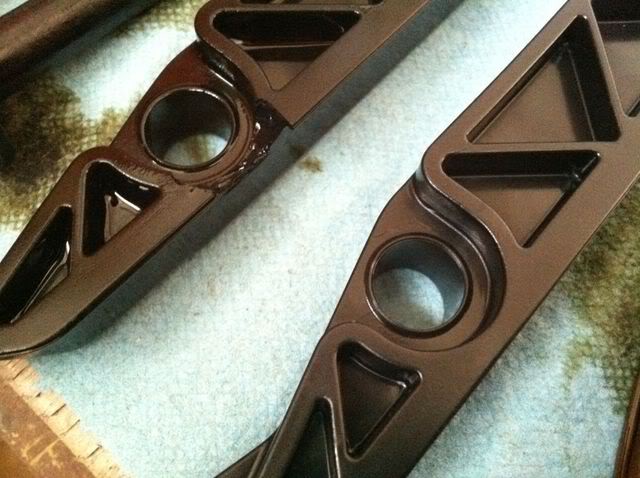

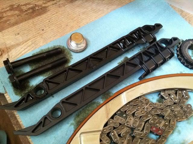

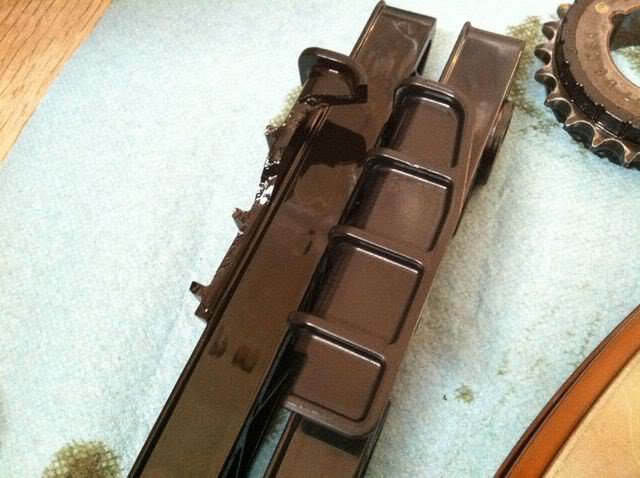

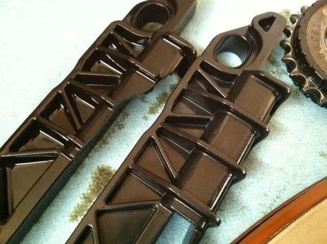

Got all the parts I needed and found that the right timing chain guide was partially broken. Replaced both actuators, guides, crank sprocket, chain, tensioner, timing cover gasket and oil sprayer. Buttoned everything up and now the car is on the road and running fine with no service lights.

Here are some photos of the chain guide that I found was broken. The pieces are most likely in my oil pan right now.
