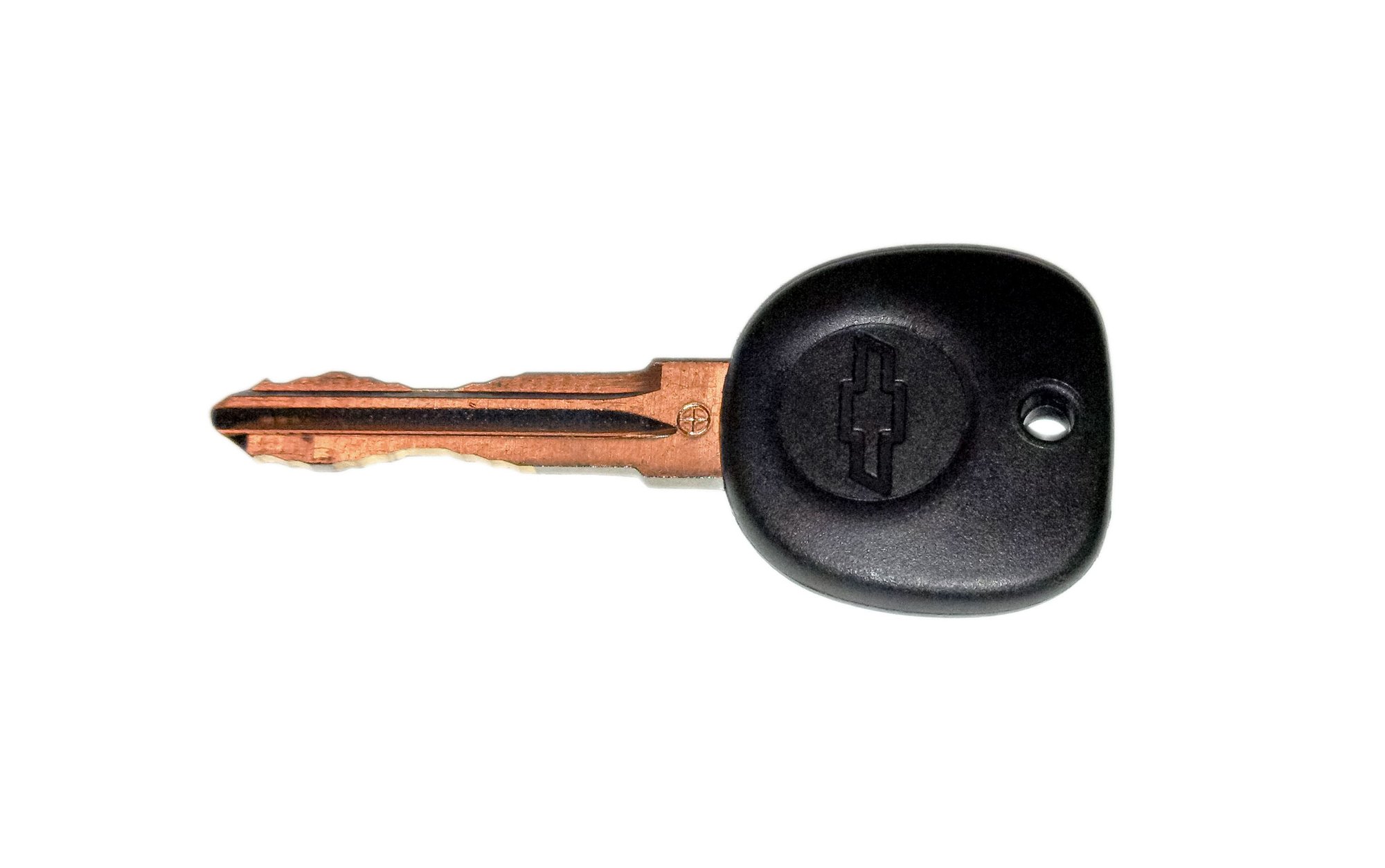

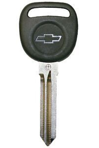

just wondering, do you know if the ignition lock was replaced during the recall? Easy way to check , look at your ignition key, small round hole or larger kidney bean hole?
Mine was replaced twice, once before the recall when it locked up on me then after recall.
