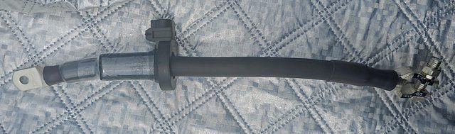

Got the replacement battery cable in: Went with the one I mentioned previously from battery cable usa for $20 after shipping & tax. Could have saved $2 going with #2 AWG cable instead, but I do plan on adding a 4-channel power amp, a sub amp, EQ, and subwoofers at some point in the near future, which might to start stressing a stock size wire. 1/0 wire will handle that & more, including reduced voltage drop, decreasing heat gain, and improving component efficiency. It also allows for better current flow, leading to more consistent, faster engine cranking and safer operation of high-load appliances like power amplifiers.
For the sensor, I cut the tape that held it to the old cable, then used heat shrink tubing to secure it in place on the new cable:
I used heat shrink because it was fast & easy, and I wasn't sure exactly where I would be able to place the sensor, & this made is super easy to remove for readjustments.

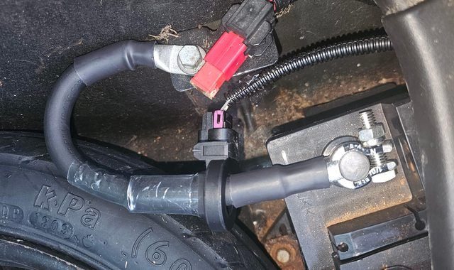

I ended up placing it near the battery to accommodate the cable bend:
Yes, it does sit above the spare tire, but it's easy to remove the spare without disturbing the negative cable.
