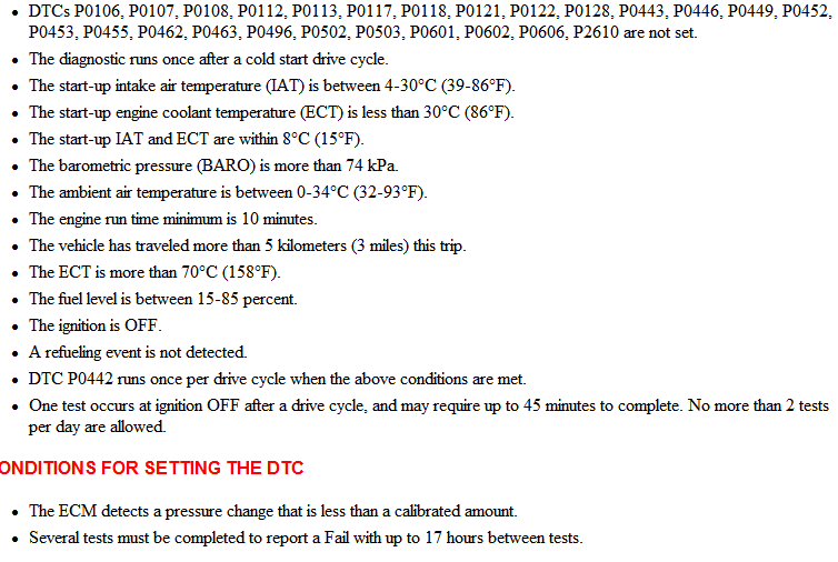

A. the counter guy was wrong; it is the VENT valve. PV483
B. sometimes it takes a while for the test to run, it takes some special circumstances including 15%-85% tank of gas. If it is the cap it should clear after the next cold start when the tank is under 85% full and you park it for an hour or so..
To be fair to the AutoZone crew; the part names are very confusing and listed incorrectly in many parts books. Both parts have combinations of "canister", "vent", "purge", "valve". The one under the hood (PV443) is sometimes called "canister purge vent valve", the one near the gas tank is "canister vent purge valve". The one under the hood purges fumes from the canister into the combustion chamber, the vent valve allows air into the tank so that gas can be pumped out of it.
