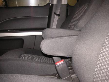

im confused on what you mean tilted down arm rest, i dont think my 07 has it does someone have a pic of theirs?

If someone can tell me how to load pictures into this thread, I'd be more than happy to show what it looks like.

If this picture thing works, here is what it looks like.
wow yea mine doesnt do that thank god
