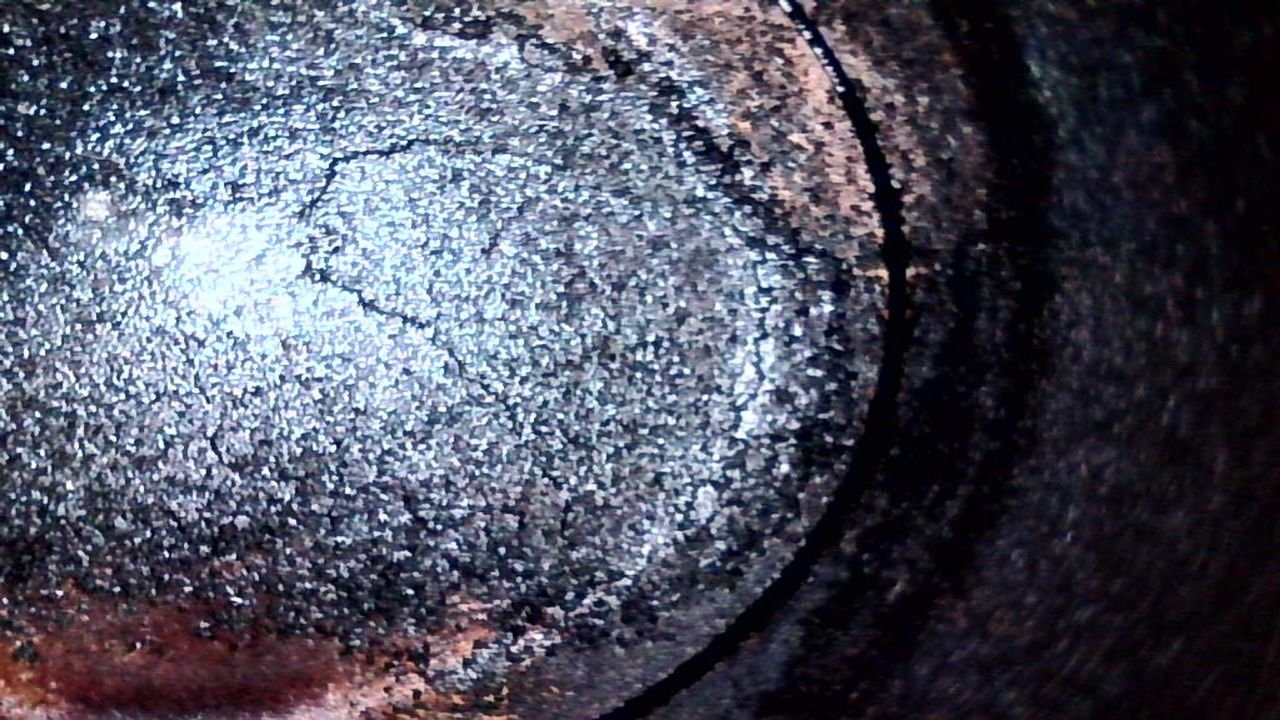

I found a borescope I have and looked into cylinders 2 and 3 and they're definitely burning oil. I gotta rotate the engine to get to the other cylinders but I'm guessing they're just as bad:

The valves are getting close to "burned", leaking anyway.
Don't stress about the pistons moving; what do you expect when you pressurize a cylinder while the others are open?
