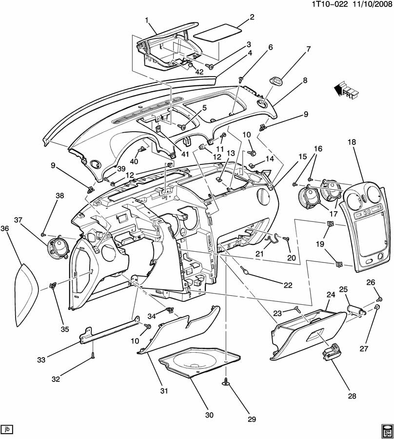

It's finally getting a little chilly outside, so I'm going to take another stab at replacing my heater core. I don't expect to finish this job in one day, but I do have a friend who is willing to give me a hand one day this week, so realistically I may be able to finish it in a day or two. I have my repair guide handy, as well as all of the tips and advice everyone here has offered, which I very much appreciate. The only thing working against me is that I don't know what certain parts of the dash are called. I can try to provide a better example when I am near my repair guide. I want to try to document everything I take apart (take photos). Weather permitting, I'm going to start tomorrow.
Old Nov 8, 2015 | 01:08 PM
  #57
whopper's Avatar
Joined: 04-09-2006
Posts: 7,043
From: Vancouver, BC, Canada
Best of luck on one nasty project. Just take your time, and don't force anything. This diagram might help a little with the dash parts. Taking pictures really helps, as well as having numerous containers you can label describing where the parts came from.
Thanks for the diagram! That will definitely come in handy.

Making some progress, but I'm currently stuck at removing the instrument panel. Per my guide:
"Release the passenger's side airbag from the instrument panel cover by pushing in on the tabs to separate the airbag module from the trim panel."
There is no illustration to go with this and I don't see what this is referring to. And yes, the negative side of my battery is disconnected.
Edit: found the tabs...under the airbag panel. MAJOR pain to take out. The instrument panel dash is off now. I have run out of daylight, so I will continue tomorrow morning
