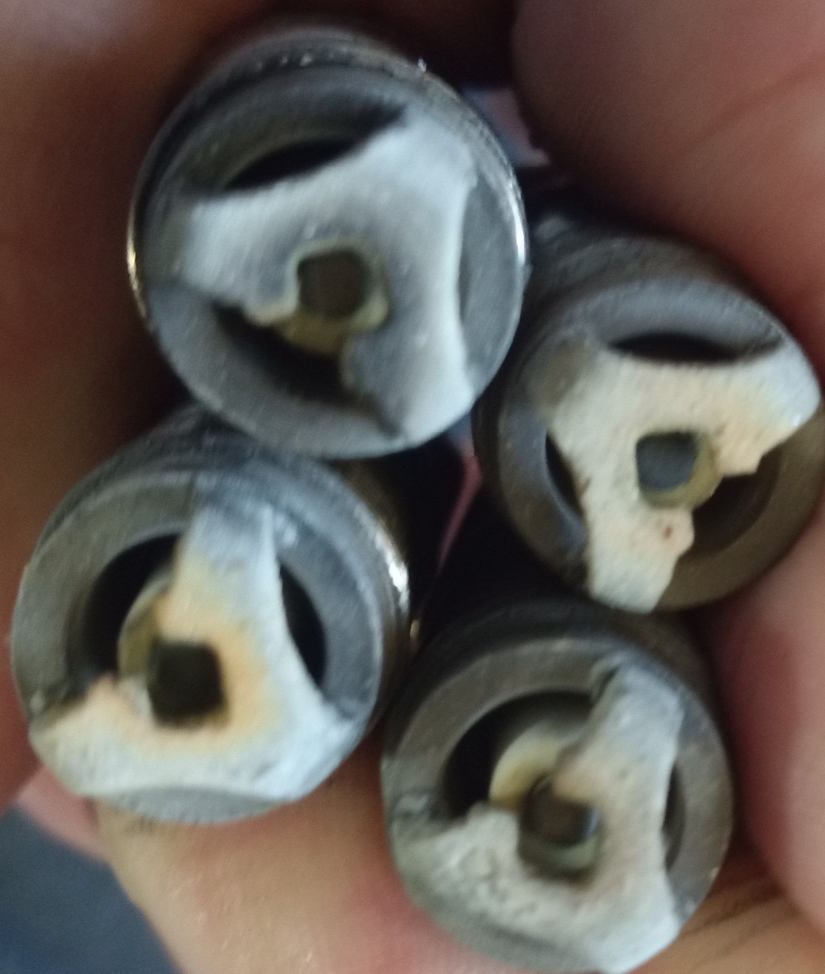

I did notice one thing when I removed my E3 plugs. I attached a picture to the feed. These plugs have less than 20,000 miles on them, but I noticed a yellowish hue to the electrode. I have never been very good at deciphering the pictures included but from my Haynes manual, those plugs appear to be exhibiting High Speed Glazing. Do those plugs look normal to you guys?

E3 sucks. Probably the problem.

What are those things in the picture? Yeah, I know, but what brand and number? Maybe a side view..

With regards to the plugs that I have pictured, they are E3.74 plugs (made by E3) with a little over 12,000 miles on them.

Ah! I thought they were all 103. Maybe 103 was an improvement/correction. Just different heat range anyway. That’s why I’d be curious as to how they looked. Also curious as to why such a specific plug preference in these motors, thinking maybe the pointy geometry of iridium electrode (in addition to its durability.)
Got curious about that gimmicky E3 plug. (Trying to imaging how a novel electrode design could increase power unless the alternative was causing misfire) I can see how the weird design might reduce detonation in some circumstances.
E3 seems to list that same E3.74 for all the HHR 2.2/2.4’s. Only seem to have one product close enough. They don’t seem to know that HHR SS (turbo) exists, but list E3.66 for the Cobalt SS. Amazon says the E3.74 “fits” the SS, shows you how much you can trust their listings, lol.
Bottom line, seems maybe the E3
E3.74 plug was both causing the idle misfires (and stalls) and causing the P0341 to be set.

This is interesting, especially "The Weakness" section. Seems to describe the condition in the OP.
E3 Spark Plugs Review: Is It Perfect Replacement? (autoactuality.com)
