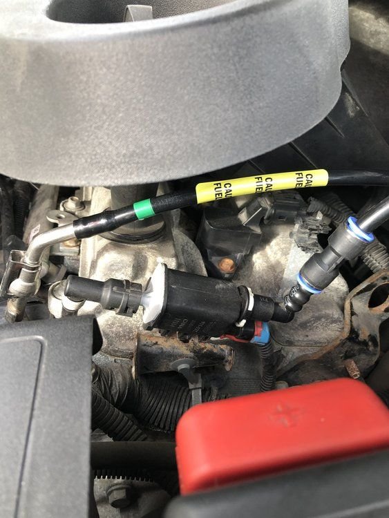

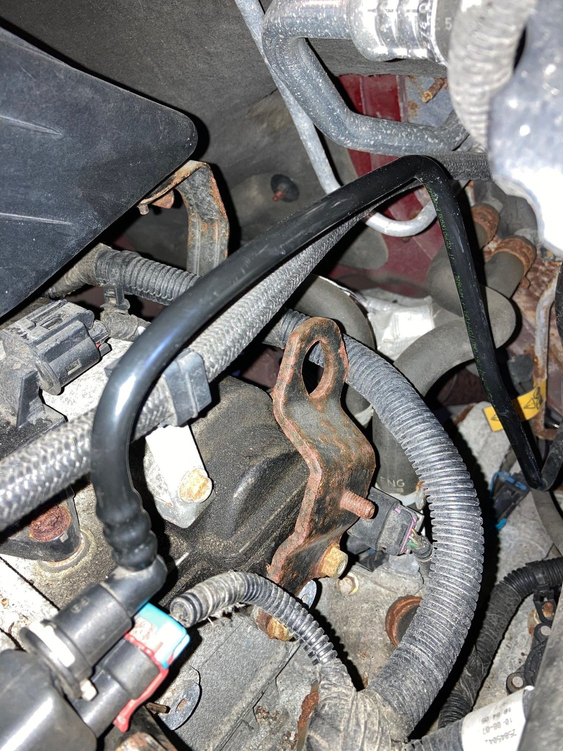

You mentioned replacing a vapor line to your purge solenoid underhood in order to eliminate a 455 code in a how to thread "fuel line follies". Did that solve the code long-term for you?
Old Apr 13, 2021 | 07:04 PM
Posts: 40,083
No more code, so yes it did resolve that code.
Old Apr 14, 2021 | 01:09 PM
dano40's Avatar
Joined: 06-02-2013
Posts: 59
From: Massachusetts
Do you remember where about the crack was? I cleaned mine and can't see or feel anything....Thanks
Old Apr 14, 2021 | 02:52 PM
Posts: 40,083
At the connector fitting
