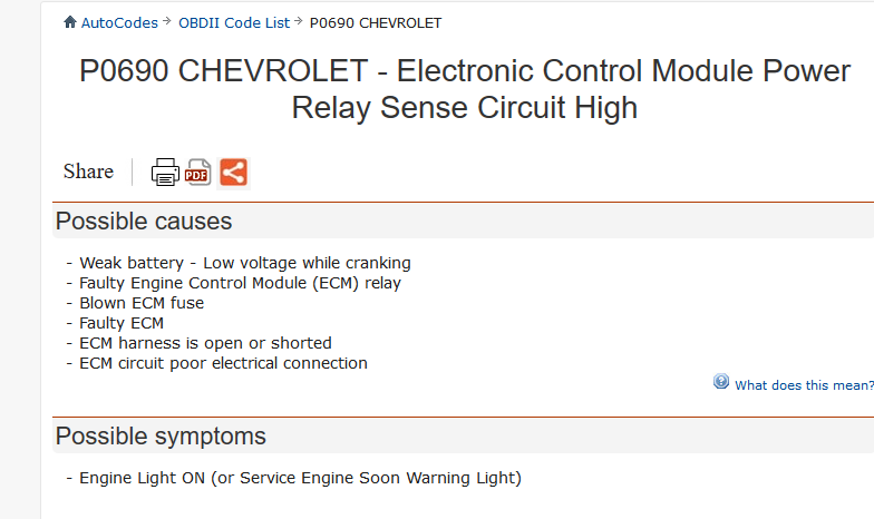

Posts: 26,538
"low voltage while cranking"
