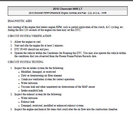

Old Jun 11, 2016 | 03:54 PM
Posts: 26,490
Mitchell doesn't have a lot of info, but here is the diagnostic procedure.

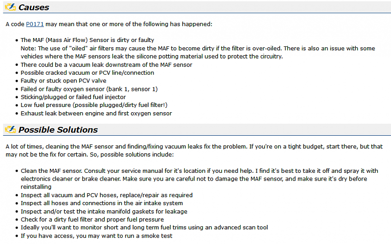

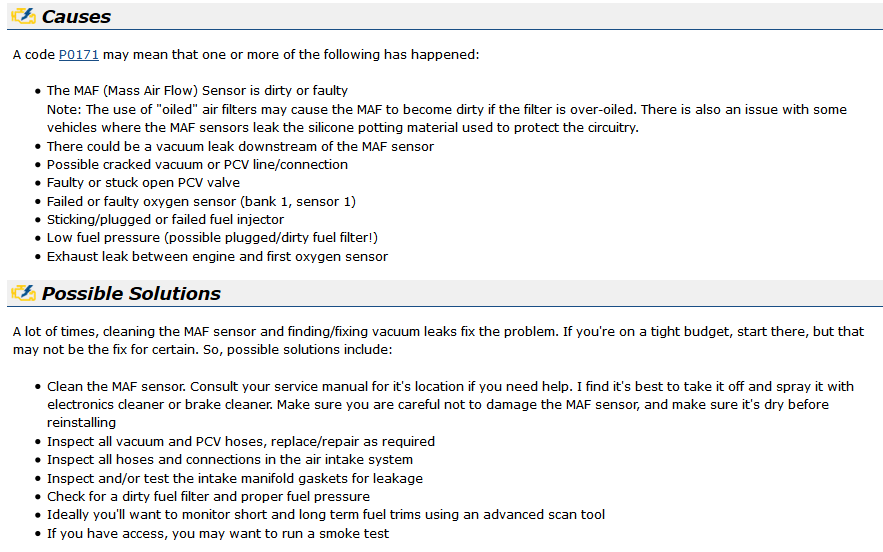

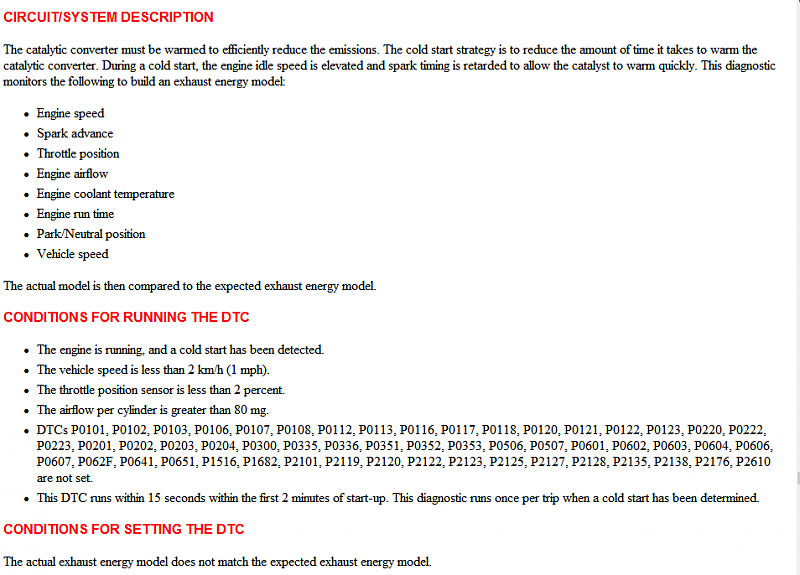

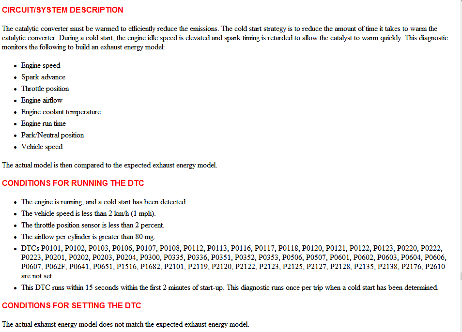

Old Jun 12, 2016 | 10:19 AM
Posts: 26,490
Did you consider that they are related? Like including that in the OP? Anything else you left out?
Note the idle speed, engine airflow involvement in the p1400 code.
I know you have "checked everything" but it sure sounds like a vacuum leak. Or a cracked flex pipe.
The top attachment is P1400, the bottom one is for P0171.

Old Jun 27, 2016 | 10:10 AM
Posts: 26,490
What both codes mean is that unexpected air is being introduced to the combustion chambers somewhere between the MAF sensor and the #1 O2 sensor.
Possibilities include:
breather tube
EVAP canister purge valve/tube
manifold gaskets
the air tube between the MAF sensor and the throttle body
throttle body to manifold
flex pipe
etc.
My favorites are:
the breather pipe and
the purge pipe or valve especially because "Each day he drove it, acted some what good and one day it gave acted bad on startup"
"Slow to start" is a frequent symptom of a bad purge valve.
Seems from reports I've heard that smoke tests are not worth doing. Eyes and fingers can do it.
