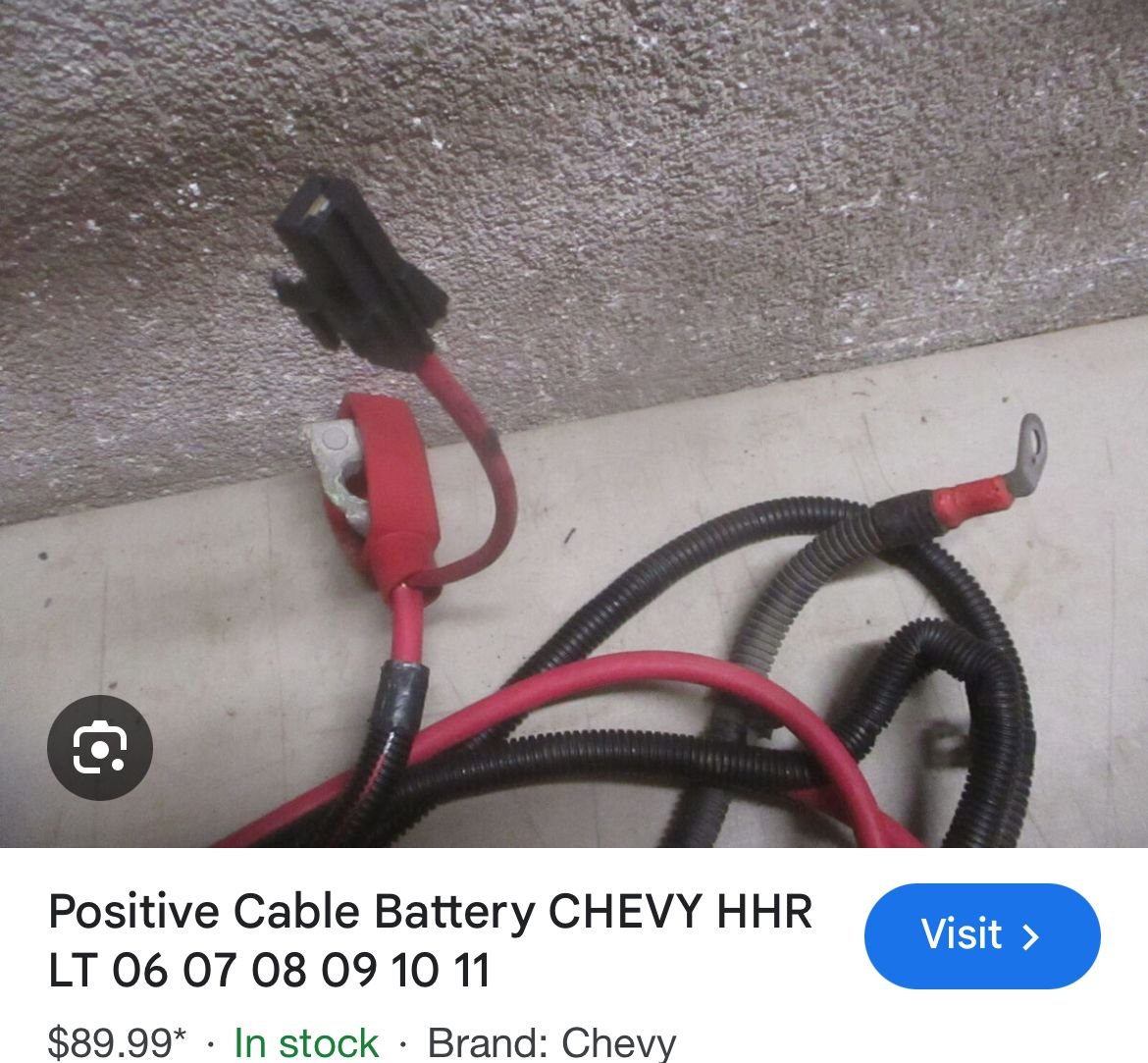

it’s a flat connector coming off the positive terminal
That is after market. Somebody added something that might be the problem. Find out where that wire goes.

I did a quick search, and it looks like the connector isn’t aftermarket, maybe I described it poorly… here’s an image of it

Posts: 26,543
The ONLY way to get "not learned" is to have a virgin ECM. They sent your old one back after they cleared it or, it is just one out of their pile.
