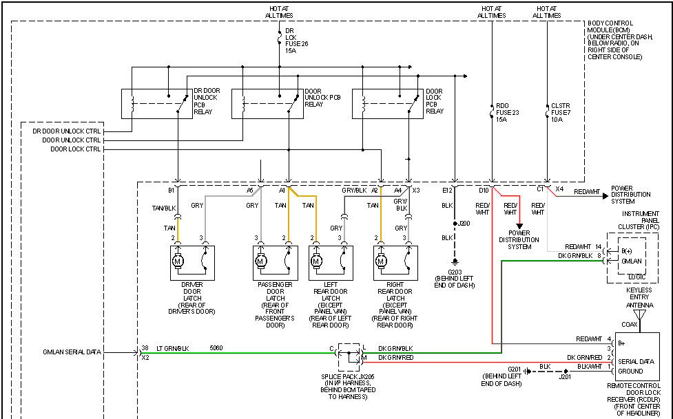

Each door lock is controlled by the BCM, so not that.
BTW, the panel rear access doors have a connection to the Instrument Panel. The IPC gets a signal from the BCM, then it activates the relay under the hood on the strut tower which sends B+ to the door lock. The BCM supplies ground to the door lock.
I'm not sure where the BCM gets the signat to lock the doors either the PNP or the shift micro-switch.
Old Mar 7, 2019 | 10:36 PM
Felony's Avatar
Joined: 01-08-2012
Posts: 51
From: NJ
Thanks for the schematic. Very helpful. I'm testing a possible cause with regards to the key fob. I just placed my finger over the unlock icon without depressing and all the doors unlocked. Didn't need to double click. I had issues with the fob not making contact so I did the aluminum foil trick and got the fob working again for all the buttons. Might be possible the foil has become loose over time and is making contact under the unlock button. Once again, there is nothing wrong with the battery. This intermittent issue has only happened twice. A low or marginal battery would be causing other issues all the time. Thanks for the replies.
