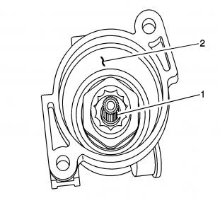

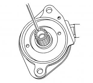

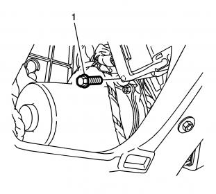

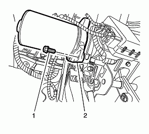

Power Steering Assist Motor Replacement (Without SS)
Removal Procedure
1. Cover the carpet in order to capture any lubricant that may drip from the steering column or the power steering assist motor.
2. Remove the driver knee bolster reinforcement. Refer to Driver Knee Bolster Reinforcement Replacement.
3. Note the location and the routing of the tie strap that holds the power steering assist motor wires to the steering column.
4. Remove the tie strap from the steering column.
Discard the tie strap.
5. Disconnect the power steering assist motor electrical connector.
Important: The bolts that secure the power steering assist motor to the steering column have a 12 mm hex head.
6. Use a 12 mm socket in order to remove the power steering assist motor upper bolt (1).
7. Use a 12 mm socket in order to remove the power steering assist motor lower bolt (1).
8. Remove the power steering assist motor (2).
Important: The worm shaft spline and the steering column housing must be clean and free from lubricant before continuing the motor service procedure.
Important: Do not use any solvent based cleaners to remove the lubricant. Only use lint free cotton cloth or equivalent to clean the area.
9. Use a lint free cotton cloth or equivalent in order to remove all remaining lubricant from the steering column worm shaft spline (1) and the steering column housing (2).
10. Use a lint free cotton cloth or equivalent in order to remove all remaining lubricant from the power steering assist motor.
Installation Procedure
Important: Only use the lubricant provided with the new power steering assist motor. Use all of the lubricant supplied with the kit.
1. Apply the lubricant into the opening of the power steering assist motor shaft. Wipe off any excess lubricant that is not on the inside of the shaft.
2. Ensure that the NEW power steering assist motor O-ring seal (1) is properly seated on the power steering assist motor.
Important: The power steering assist motor should engage evenly and with ease. If the motor will not engage the steering column then remove the motor and try again. Do not force the motor and the steering column together.
3. Install the power steering assist motor to the steering column with the wire harness facing upwards and towards the front of the vehicle.
Important: Do not apply any side load to the power steering assist motor while torquing the bolts, or you may induce a noise or a vibration. If a noise or a vibration emanates from the steering column, remove and install the motor again.
4. While holding the motor in place, install and finger tighten the 2 power steering assist motor bolts.
5. Tighten the 2 power steering assist motor bolts evenly, alternating between the 2 bolts, until you reach the specification.
Tighten
Tighten the bolts to 19 N·m (14 lb ft).
6. Connect the power steering assist motor electrical connector.
7. Install the NEW tie strap in order to hold the power steering assist motor wires to the steering column in the correct location.
8. Install the driver knee bolster reinforcement.
9. Road test the vehicle and ensure that no noise or vibration emanates from the steering column.
