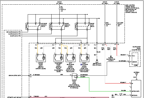

Did you look at the schematic?
First question is: do they power UNLOCK?
Second question: is it BOTH front door buttons?
Third question: what about the fob?
Fourth question: what about auto lock; Locking the driver door then closing it.
Fifth question what about auto lock/unlock: when you move the shifter in and out of park. Setting in the DIC.
If you need a Owner Manual see the link in my sig.
