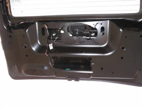

I looked at it I can't see how to get to it, Even with trim off

Not too easy to get access...

The best way is to drill a hole in the side and the tool gets better leverage to the spot.
I had mine off and it is just not in a good place to get to it. My dent guy is the best one I have ever seen but they need good leverage to work it out.
