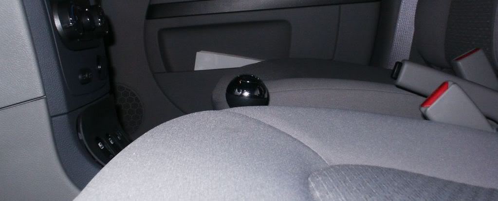

The knob is now about level with the top of the seat bases, it's a little low, but not uncomfortable. Shift feel is about as good as it's going to get with a cable shift, driving my SS (with a B&M short shifter that engages directly into the shift rail) feels very direct and notchy by comparison. Sadly today it gets its dust cover put on, and won't be going anywhere till the salt's gone next year.

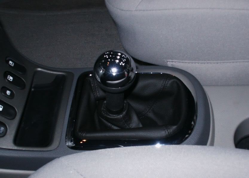

I did eventually manage to get the console out far enough to get to the heads of the bolts, and get everything tight. A few scars but well worthwhile for a basically free mod.Name:  5952.jpg
