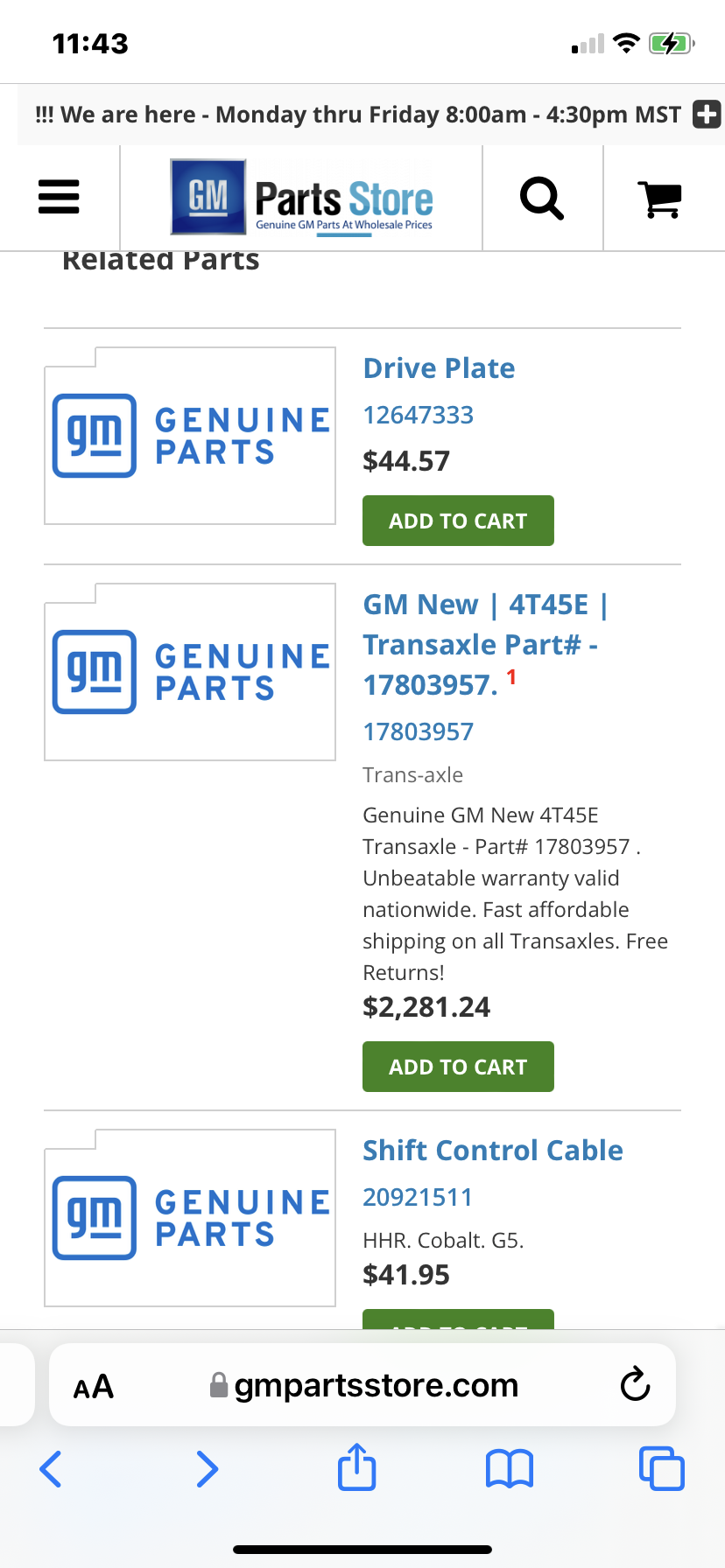

Ok, but the last time I bought a transmission from GM , it included the fluid, torque converter, harness and TCM .
that was 3 years ago but still.
New transmission, then there’s shipping.
