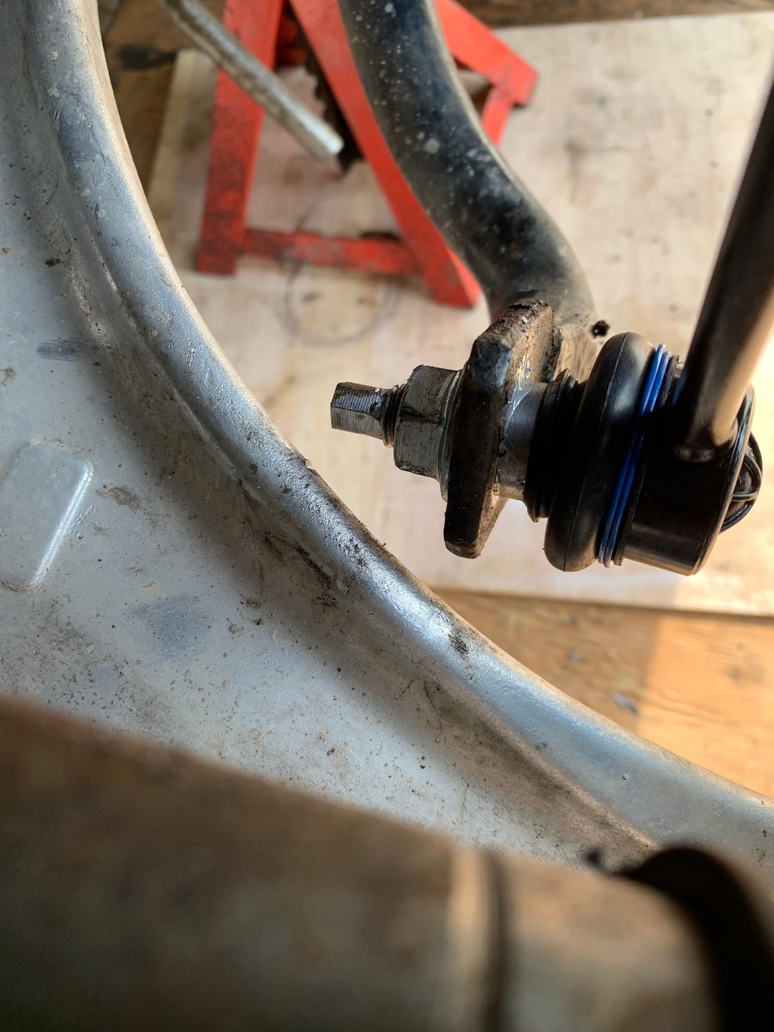

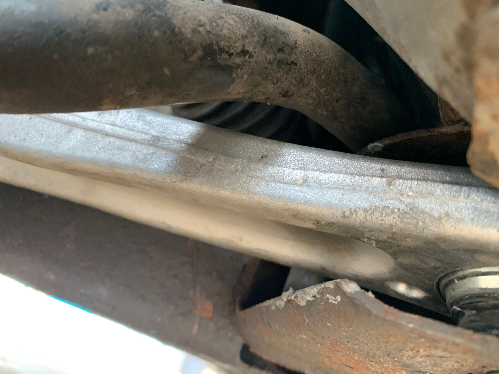

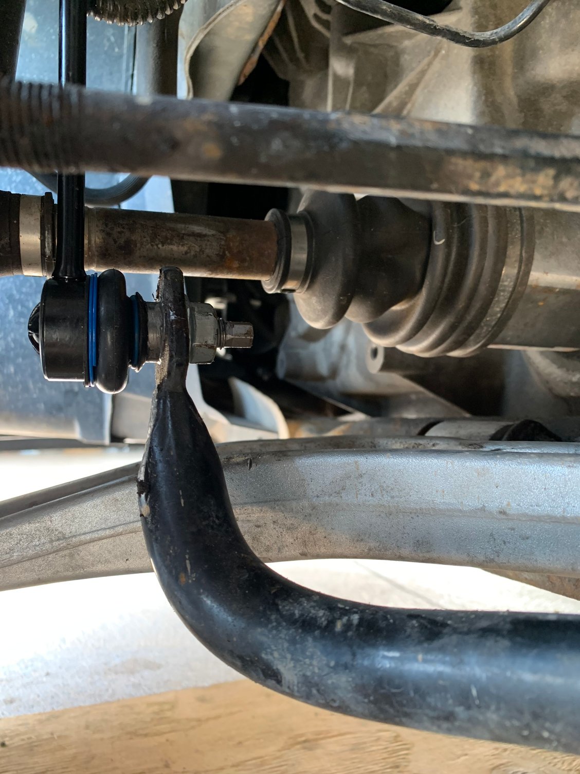

Oh and on those pictures of the 11.8" end links... if you look closely I think you will see where the end of the stud hit the lower arm and made some scoring marks... that is what happened when I put the 11.8 on the passenger, with the original 9.8 on the driver & removed the jack. I'd bet when those 11.8" arms move to an extreme the bolts impinge on the lower A arm

If there is a 11.8 inch long link on one side and a 9.8 inch short link on the other , then yes, that will cause interference somewhere.

This mark on the aluminium lower control arm is from the wrench to hold the ball stud, while torquing the 18 mm nut to 59 ft/lbs
For the top, it’s clear there’s lotsa room, that mark looks more like from the 8 mm wrench to hold the ball stud to torque the nut to 59 ft/lbs
Up high from the rear, it’s clear it’s a mark from my 8 mm wrench
