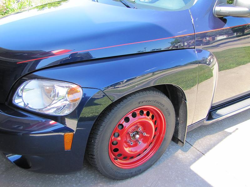

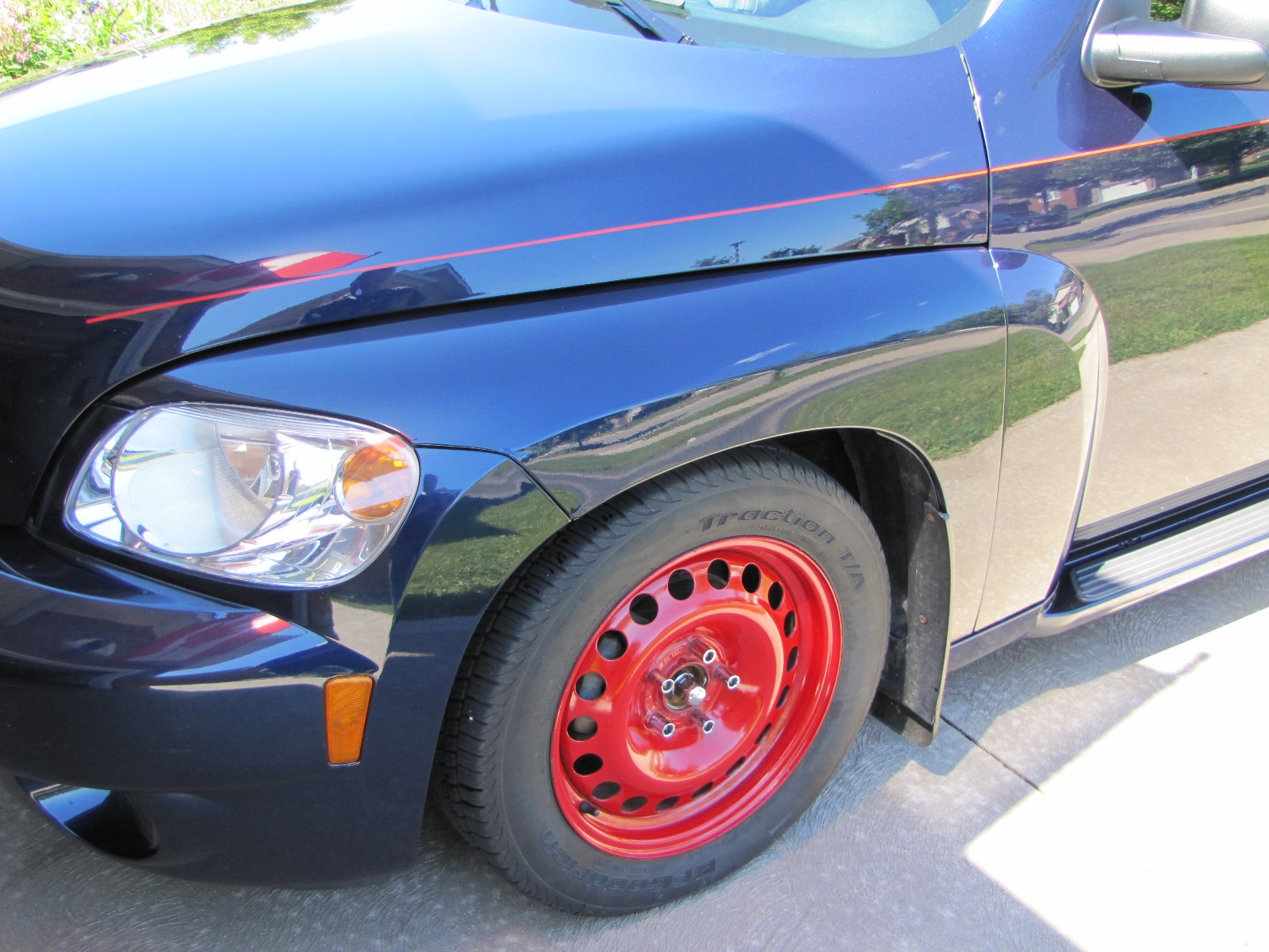

My 16 inch , 18 hole steelies fit over the non Brembo SS 11.65 in disc brakes.
I've read a few threads where SS owners have put on 16 inch rims for winter tires
