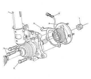

I have the same issue since 1 year and two months. I thought that the noise was designed to recreate an old fasion style (LOL) When I´m driving in a straigth way, I can heard a rumble noise in the driver´s side, but if I still driving and make a turn, is getting worst. I made a test today. I lift the front of my hhr, to keep "in the air" the wheel. I turn on the engine, put in drive without press gas pedal, and the driver didn´t move, just the passenger side! Also, I manually rotate the wheel, and the tire is really hard to turn...Then, I think that is the hub bearing. I just ordered the part to the dealer, I´m going to wait about 2 week, Ironic If I live in México, and living about 60 far where the HHR is made. I´m going to make this work. I´ll keep you posted...
Old Aug 12, 2010 | 11:46 PM
Yep, sure sounds like possibly a hub bearing, from your tests..
Here's the diagram & torque specs, HHR Axle nut 81 ft lbs, & Hub bearing bolts are 85 ft lbs
Good info/diagram Sleeper
