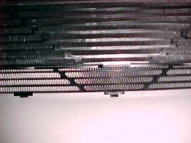

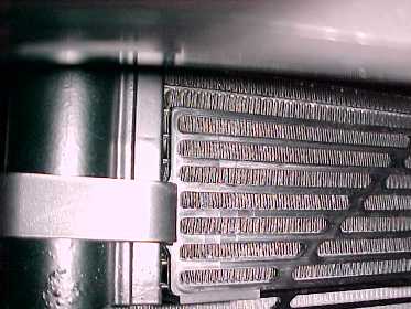

Here are 2 pictures of the guard that can be installed on the lower a/c condenser and radiator for protection against rocks or debris hitting them and causing a $900 leak.
The TSB for this is 08-06-02-001 and I think if you are under warranty and went to your dealer telling them you are concerned that a leak could occur if these items are hit by road debris, give them the bulletin number, they should agree to install it.
If you are out of warranty and want to install it the part # is 25829960 and you should be able to get it for less then $25.00. It takes all of 2 minutes to install.
This piece along with a lower grille mod should protect you from damage to the radiator or condenser. But nothing is 100% certain!

chevymgr.... do you by chance have a picture of this on .....

Those are the installed pics, it only covers the bottom two inches, which is the exposed area. The protector is the black portion covering the fins on the condenser. The first pic is looking through the lower grill opening. I will try to get a better pic. It will help, but as you can see there is still a possibility of something getting buy the guard too.
