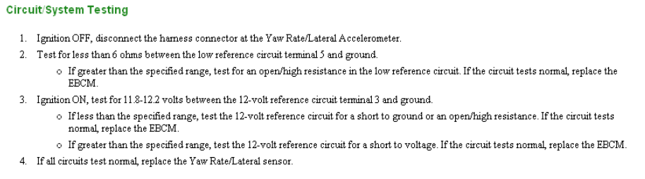

Here is the diagnostic for C0292:
Could be a wire or connection. The yaw sensor connects to the EBCM. The connector on the EBCM is a suspect. You might check the connector to the SCM, it is under the console behind the shift lever.
The yaw and lateral acceleration sensor is under the passenger seat behind the mounting hump
Did you get any repair history from the previous owner, Or accident history from CarFax?
My experience was that the ESC would activate on mildly swerving roads, throwing the car all over the place.
