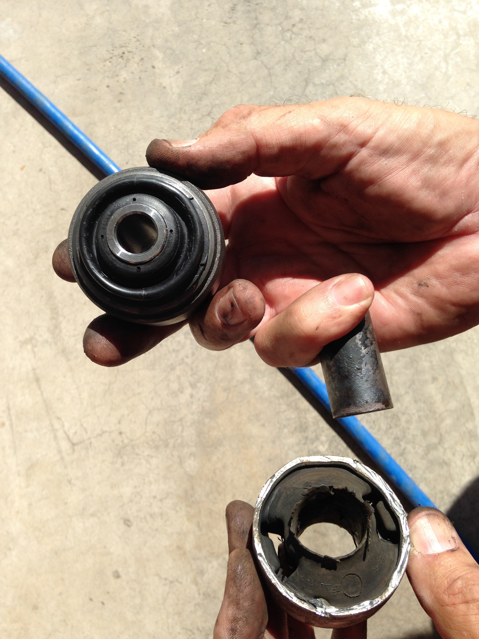

Posts: 40,083
If you want to just change the rear bushing get the K200792 Problem Solver bushing , it's the one on the left, the one on the right is an OEM bushing with 41,000 miles on it!
