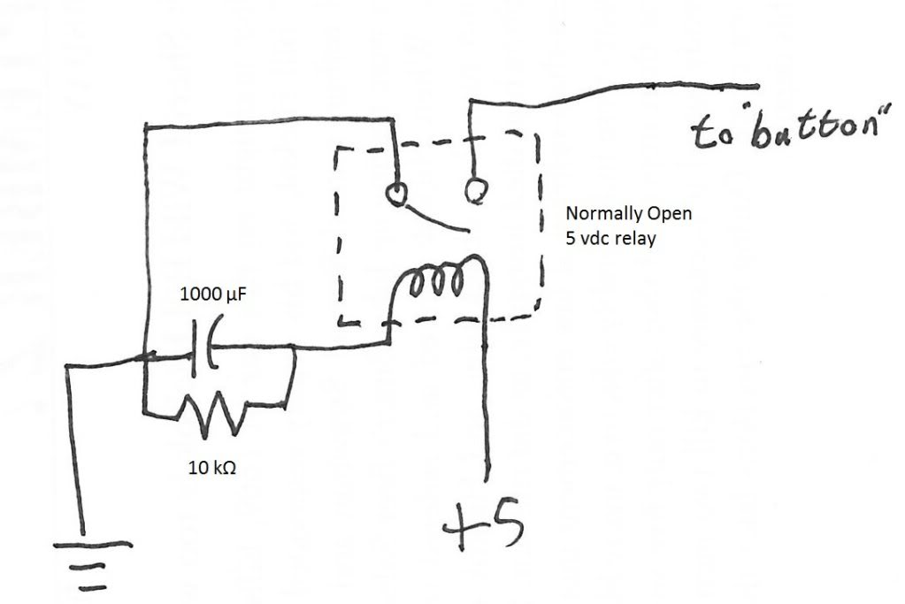

I found myself thinking, "Gee, what I really need here is something to automatically push this stinking button for me. Then I could have otherwise normal control over the AC system, but I wouldn't have to push that button all the time."
Talking a bit with my buddy Google lead me to this circuit which takes a constant input and turns it into a momentary one (Note that I did not create this circuit, I don't claim any credit for coming up with it):

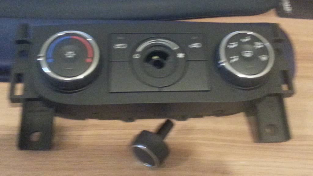

To open the AC controller case, start by pulling the AC fan speed knob loose from the front of the unit. It should slide off fairly easily (sorry for the blurry pic, but details aren't vital on this step, so I didn't retake it):

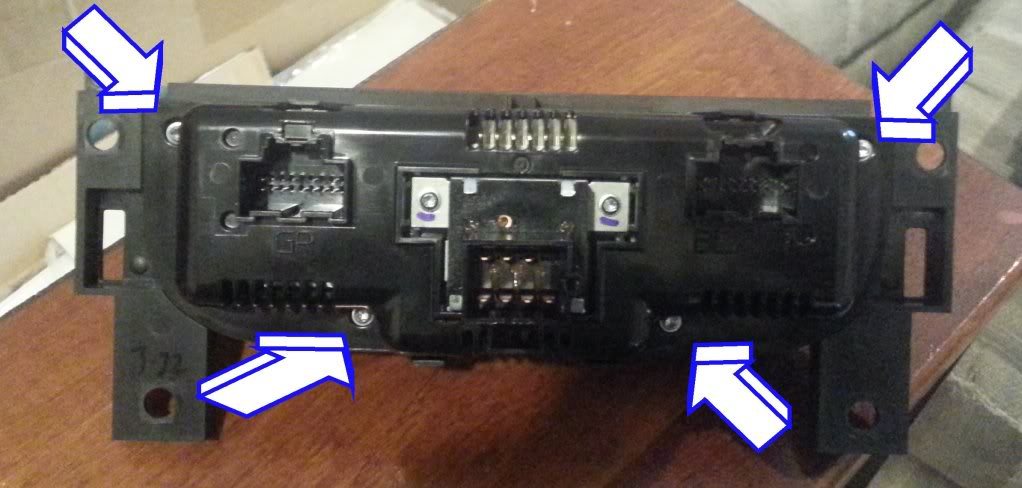

Next remove the four torx screws on the back.
Now there are four tabs (two each top and bottom -- they're pretty obvious from looking) that are holding the two pieces of the unit together, gently pull them away from their catches and tease the two parts apart.

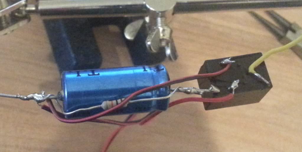

I suggest building the assembly first, probably even before you pull the AC control unit. Follow the schematic above, for this. You need a 1000µF capacitor (rated at greater than 5VDC), a 10kΩ resistor (.25 Watt is ample) and a relay that has a normally open connection and can be triggered by 5 VDC. The rest of the details aren't important. I had most of these parts lying around from a past life, but some web research suggests that they can all be had for about $10 -- that's from Radio Shack, whose prices are generally kinda high.
A note about the capacitor for the uninitiated: a 1000µF cap is pretty much going to be an electrolytic capacitor. Those things have a specific positive/negative orientation which needs to be complied with or they will burst. The orientation is always pretty clearly marked, so please pay attention. Also, these things have a rated temp and lifetime. Parsing those ratings to real world conditions gets complex, but if you find something 185°F or higher and 1000 hours or greater the cap will almost certainly outlast the car, unless you live in Death Valley or something -- it's the heat that does for them.
Due to the capacitor needing some time to discharge when the power goes off, this "button pusher" circuit does take some time to reset (about 30 seconds for my build), so turning the car off and back on within that discharge period means that it won't push the button again that time, but that shouldn't be an issue very often.
I'm not including much detail on connecting the parts because it's of limited use. Your components may not look like mine, so how exactly I hooked them up may not be helpful. If you can follow the schematic, you'll do fine, if you can't, consult a friend who can. Here's a picture of my assembly after soldering, just for grins.
Once you've built it, I suggest wrapping it in black tape or heat shrink tubing or whatever pleases you and is handy. I didn't have any heat shrink tubing big enough, so I used black tape.

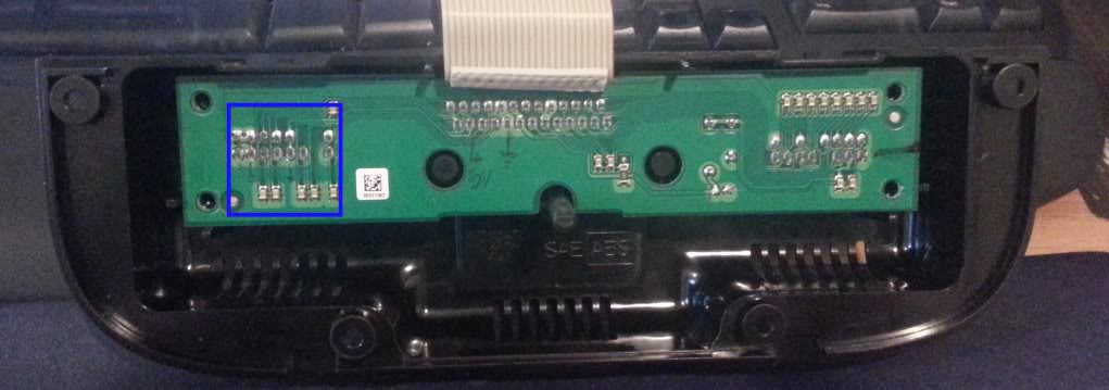

Here is the "back" board (that is the one that is in the back part of the control assembly):
And here is the part of it we're interested in:

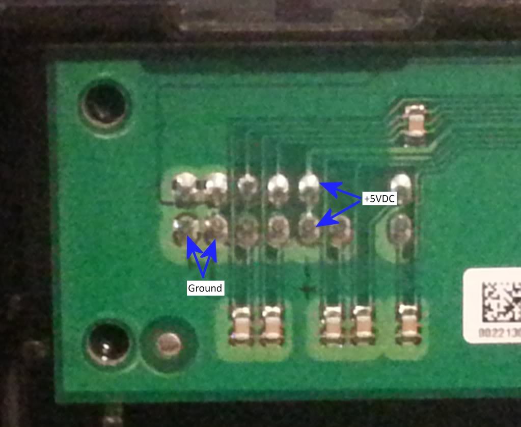

Soldier the indicated ground and power pins to your wires from the button pusher circuit you built (make sure you match them!), then tuck the assembly into the space at the bottom of the enclosure. I added some double sticky foam tape to inhibit rattles. Rattles being another thing that makes me nuts.

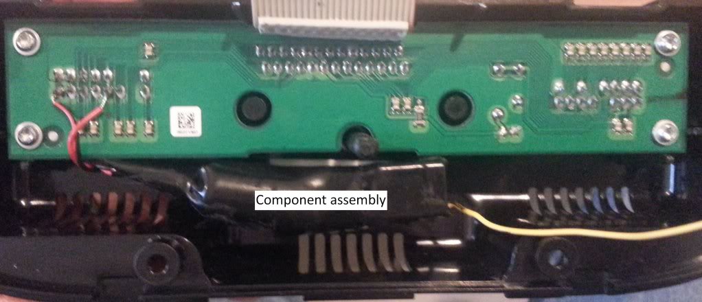

Here's my assembly in place:

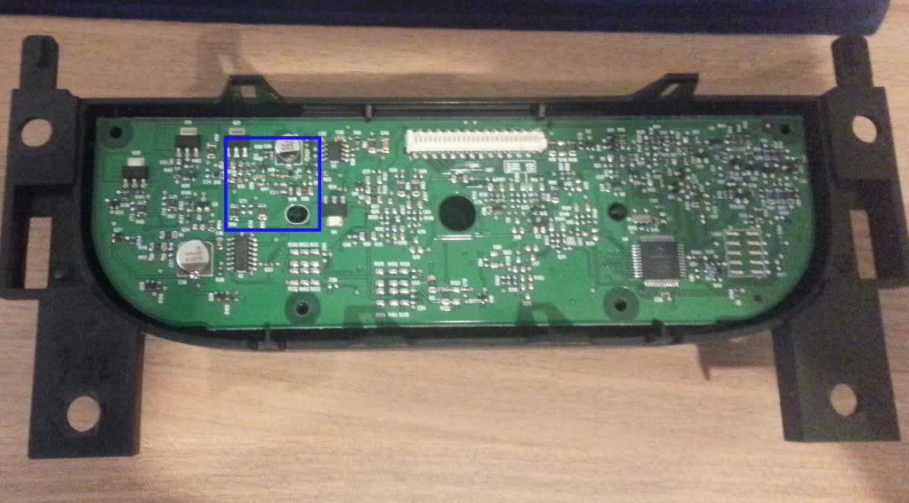

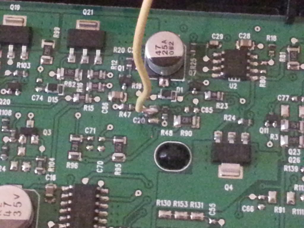

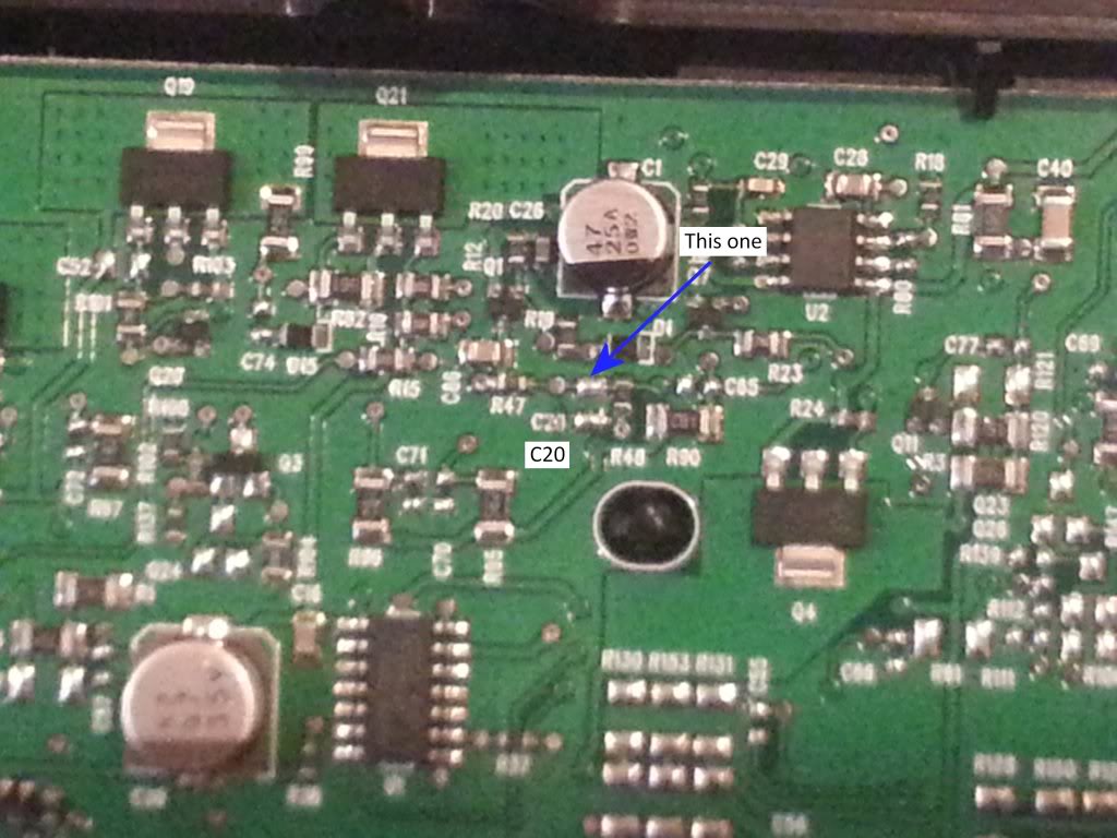

Now for the twitchy bit. Here is the "front" board:
And here is the bit we're interested in:
Note the label "C20" just below our target solder pads -- it's helpful for determining that you're in the right place.
Also note that we're interested in the second pad above that label. The bottom one is a ground connection, so not much help.
Before you solder here, please be aware (if you aren't already) that you're working next to surface mount components. They're pretty heat sensitive, so do your soldering quick-quick like a bunny rabbit, lest you slag something. Slagging is bad. Slagging lets out the Magic Smoke. If you let the Magic Smoke out of anything, the control console will very likely stop working properly. You have been warned.
Also, make sure you don't accidentally over solder to any other bits on the board. That could be ... not good, and is also likely to make your controller unit malfunction.
Here's the connection actually made, just to be thorough:
