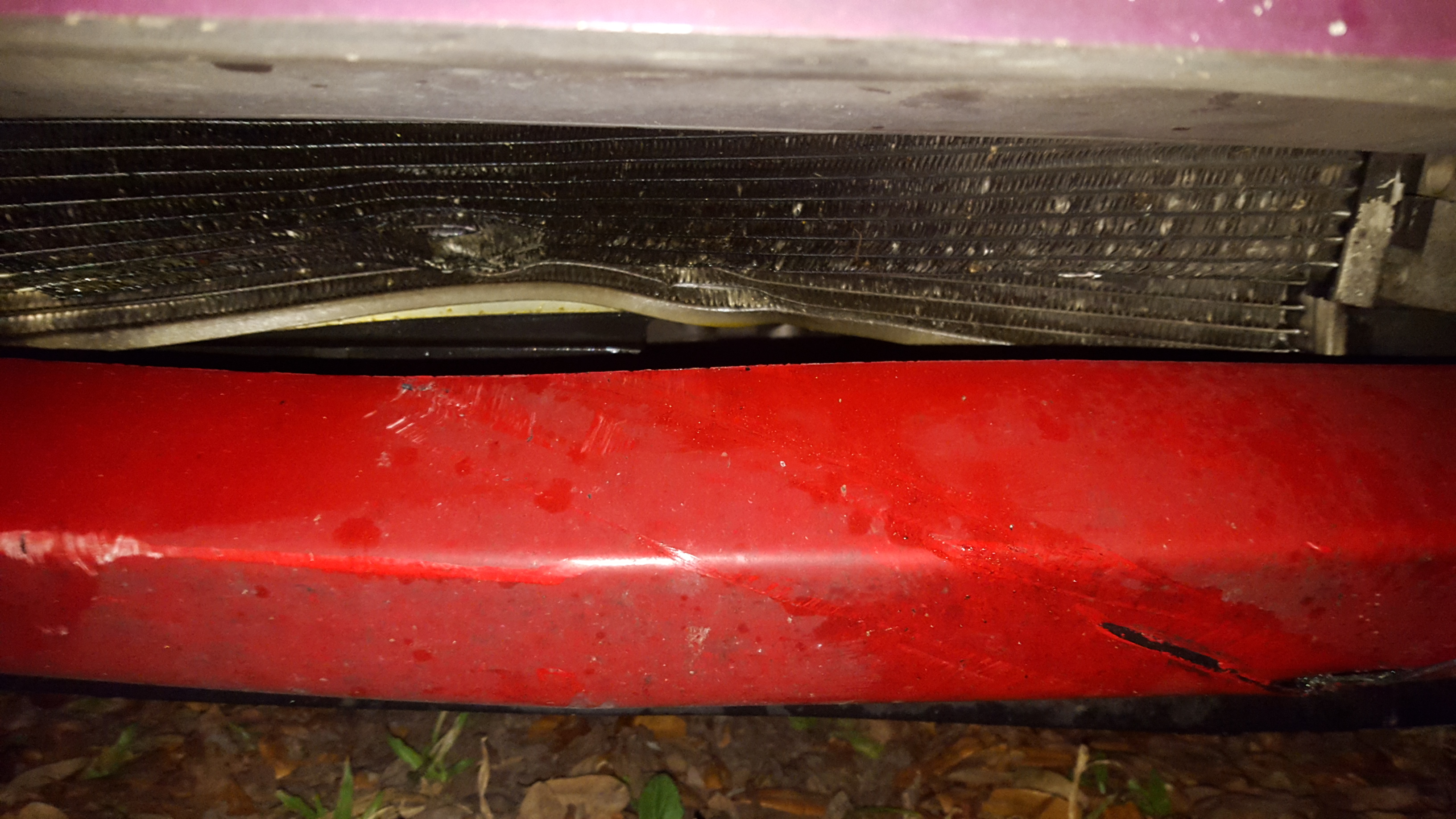

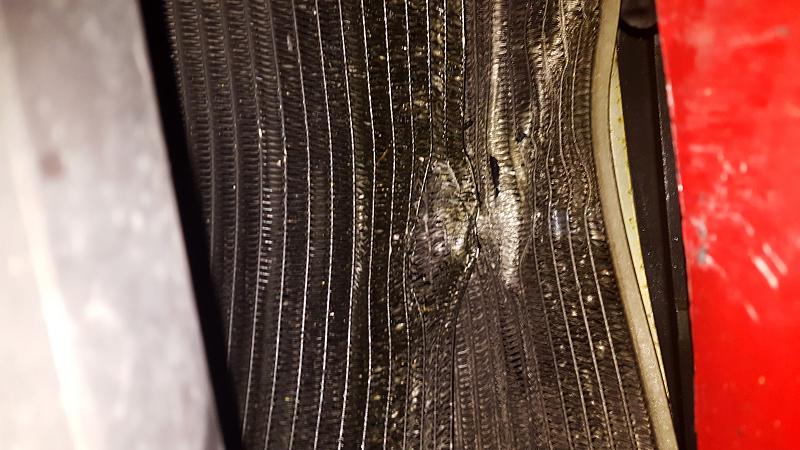

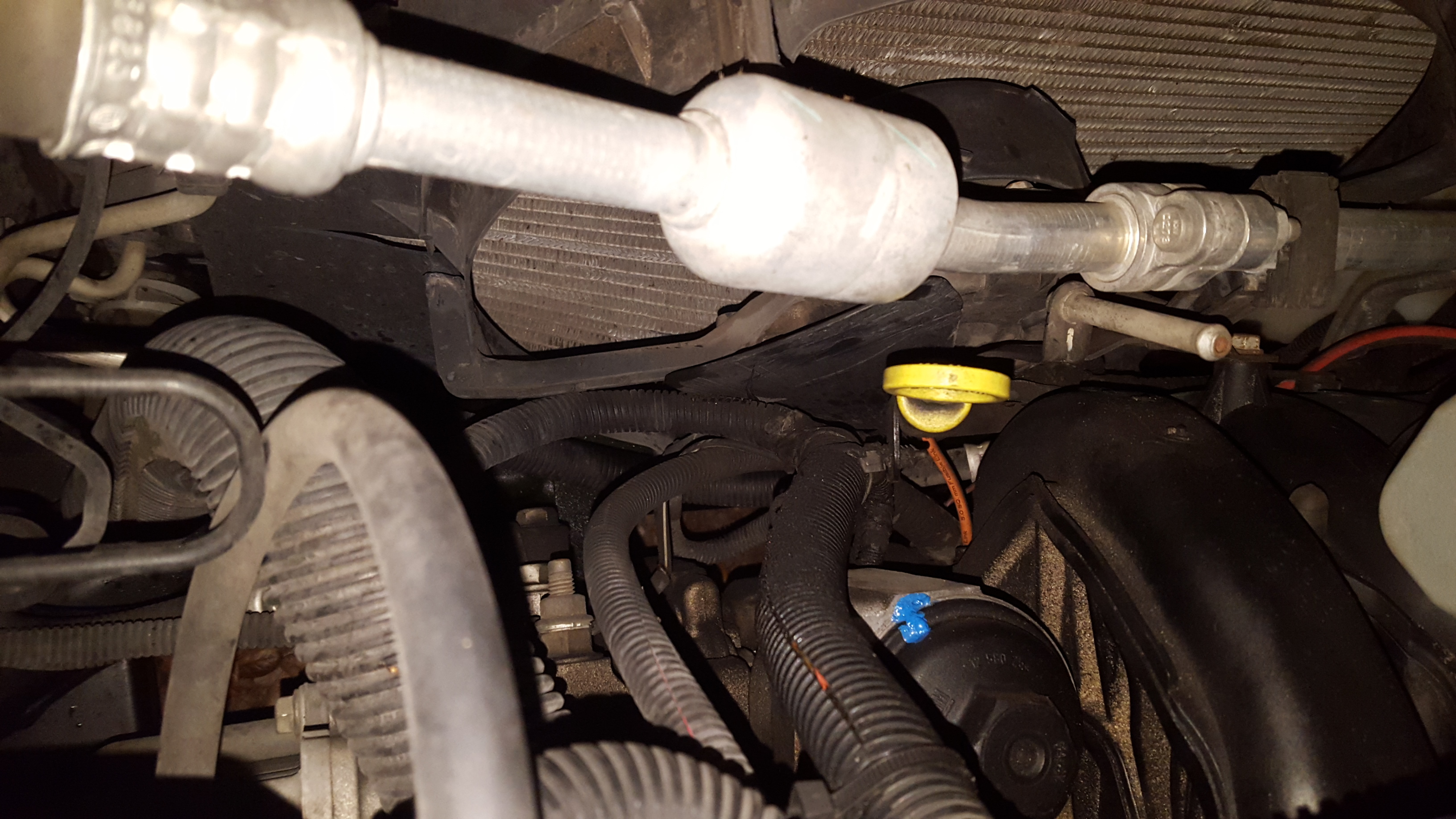

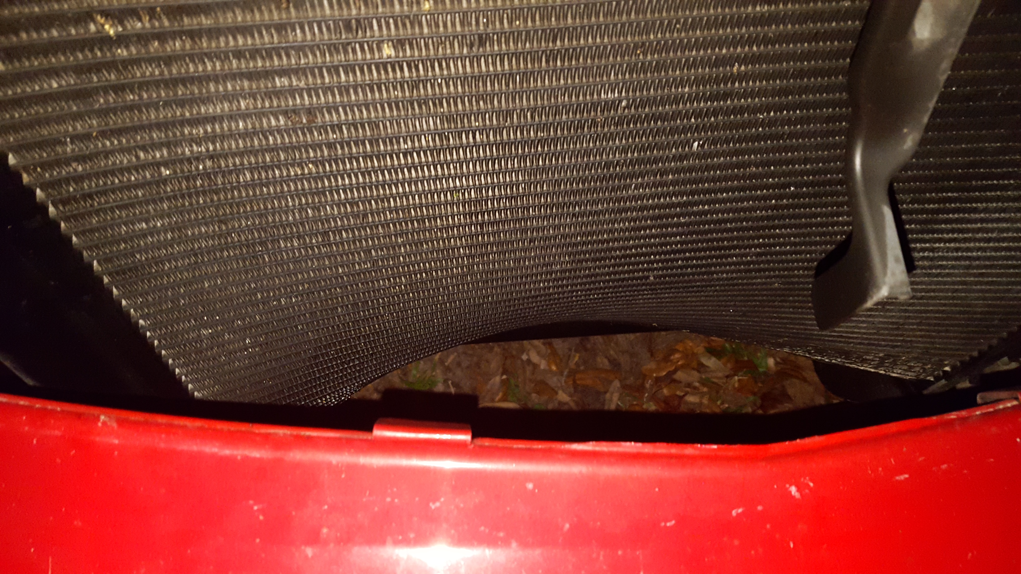

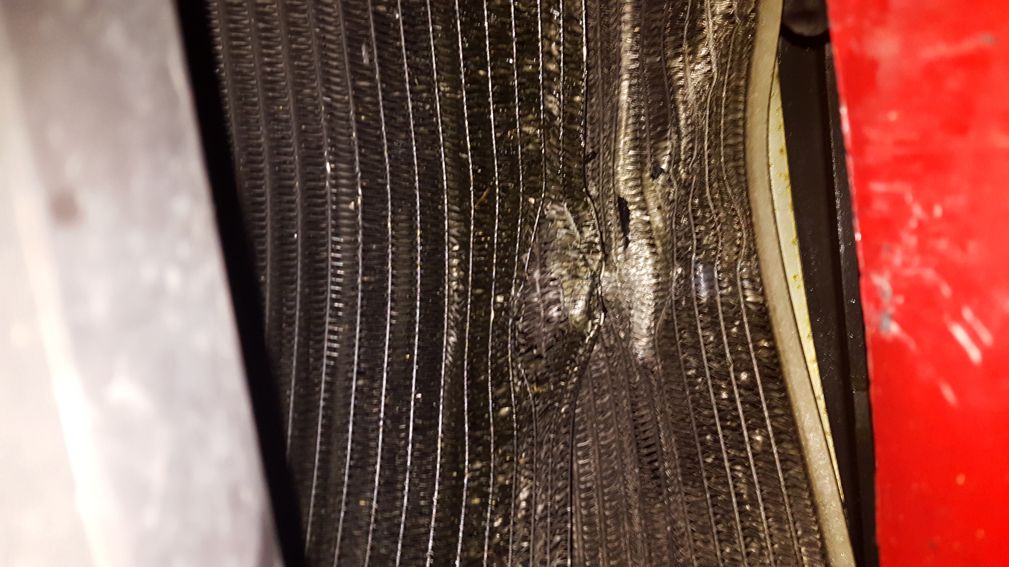

Ok so my fiance has a 06 HHR LS and on her way home from work something came flying at her car on the interstate and completely smashed in the radiator, fan, and a/c condesor at the gap below the grill. She didn't bother stopping to check it (or pay attention to the temperature) so she kept driving until it stopped accelerating... GREAT!!! (sarcasm) So I ordered a ODBII scanner to check the codes before proceeding with anything and these are the codes I got:
        Now the radiator was pushed pretty much against the block and the enging fan destroyed (all the fins broke off it)
        My question is, based on this info should I go ahead and replace the radiator and fan and a/c condesor and go from there? Or what else could possibly be wrong? I've attached some pictures off the damage.

        "She didn't bother stopping to check it (or pay attention to the temperature) so she kept driving until it stopped accelerating.."
        This part does not sound good. If the temp reached 246 degrees or higher and she kept driving, she may have destroyed the engine. I would be more concerned with checking the engine condition before putting in the radiator and fan components.
        Any chance she has insurance to cover this ? If so, and the engine is bad, it will most likely be totaled.

        Haha, yea if only it was that easy. Now another question, the a/c condenser basically exploded as seen in the pics, I hooked up a ac gauge from them refill cans and the pressure on the high side is 0, should I be safe to remove the condensor? I just don't want anything under pressure blowing up in my face :p
