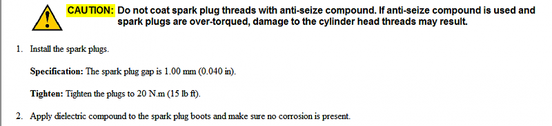

DO NOT TOUCH THE GAP. GET ONLY 41-103.
41-103 comes gapped correctly and can be damaged trying to change. Other cheap plugs may have a different spec, plugs are different. Somebody may have fat fingers. Trust the box, not the internet typing skills.
Change them when you want to; but, the "book" says 100,000 miles. I have seen them last much longer.
From the Service Manual:

Anti seize compounds are typically composed of metallic,
electrically conductive ingredients. If anti seize compounds come in
contact with the core nose of the plugs, it can lead to a misfire condition.
Anti seize compounds can also have a torque multiplying effect when
installing plugs. This can lead to thread distortion and thread galling
resulting in cylinder head damage.

I've discovered that the older threads are more likely to have bad advice. The vehicles were nearly new, not many people had experience with them. Now more time has passed, we understand the vehicle better. Call it a learning curve.
With regard to antiseize, you ignore the manufacturers recommendations at your own risk.
15 lbs ft as donbrew quoted above. And that's not very tight, barely more than hand tight for me. But after heat cycles, they're pretty darn tight.
