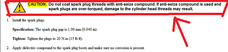

Well, you can believe everything you read on the internet or you can believe the Official Chevrolet Shop Manual that I posted. It even gives a reason.
aradmahogany Sep 14, 2016 09:35 AM
They dont put caution in all caps and bright yellow for fun.
firemangeorge Sep 14, 2016 09:44 AM
1 Attachment(s)
Just to clarify.
Attachment 20043
donbrew Sep 14, 2016 12:26 PM
What all "thread sealers" , including teflon tape do is make it easier to twist in, thus defeating the torque spec. They also do fill the gaps that are left between the threads, like nail polish.
Note #2 in the procedure "on the spark plug BOOTS".
