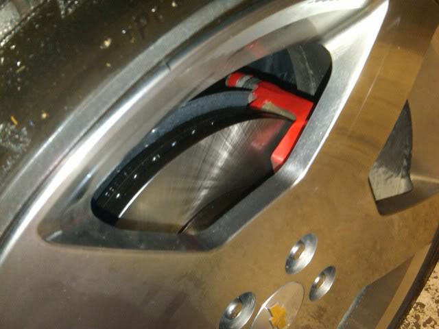

Yep I still got the premium ones though, so they wont rust.
